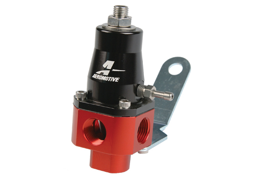

I use Aeromotive 13301, adjustable from 3-20 psi around the same price.

swood   Ok, so now I'm looking for a fuel pressure reg...   Dec 18 2009, 10:08 AM

kg6dxn   I use Aeromotive 13301, adjustable from 3-20 psi a...   Jan 2 2010, 08:28 PM
swood   I use Aeromotive 13301, adjustable from 3-20 psi ...   Jan 2 2010, 10:50 PM
KaptKaos   http://www.cbperformance.com/catalog.asp?ProductID...   Jan 2 2010, 10:57 PM
swood   http://www.cbperformance.com/catalog.asp?ProductI...   Jan 2 2010, 11:06 PM
KaptKaos   Return line? Why would you need a return line wit...   Jan 2 2010, 11:12 PM
swood   Keep the fuel circulating and cool. Not necessary,...   Jan 2 2010, 11:15 PM
