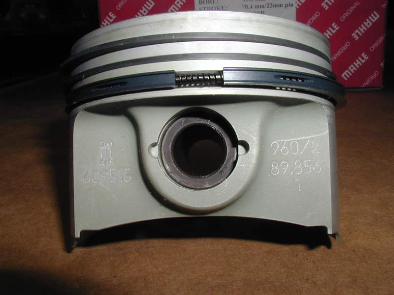

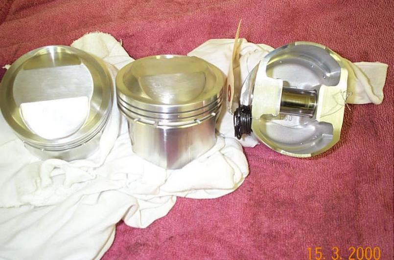

I had 9.7:1 Shasta pistons (JE forgings)in my first 2.7L. There was enough cold wall clearance to throw a cat thru....... .004+. They rattled like hell when cold.
I think the rings never did seat properly. I pulled it doen after 7 years after a leak down test when WHOOSH. The pistons were still in nice shape but the cly walls were scored......then one of them "deals" on Pelican popped up. I had a set of 10;5:1 Mahle P/Cs within 15 minutes of their posting. Cold wall clearance is .0015 and they came with Gotez rings......not cheep, but by God does it run .....on race gas.
A couple pics. The Shastas after tear down & some cleanig & the Mahle pistons.
The Shastas are prettier.
