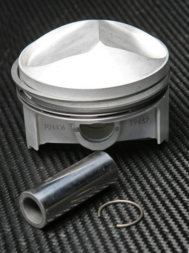

Is this piece of shite any good? (IMG:style_emoticons/default/idea.gif)
What's it worth?
I've seen the JE's I think from a reputable dealer they're about $1200 with rings....
I shouldn't even be looking at this crap (IMG:style_emoticons/default/slap.gif)

Mark Henry   Is this piece of shite any good? :idea: What...   Jan 3 2010, 12:36 PM
J P Stein   Not ehuff info for me......but that's a hell o...   Jan 3 2010, 06:35 PM
Mark Henry   mahle RSR   Jan 3 2010, 06:41 PM
Mark Henry   side http://forums.pelicanparts.com/uploads15/Pis...   Jan 3 2010, 06:43 PM
Mark Henry   Box http://forums.pelicanparts.com/uploads15/Pist...   Jan 3 2010, 06:44 PM
Mark Henry   :) http://forums.pelicanparts.com/uploads15/Pisto...   Jan 3 2010, 06:45 PM
J P Stein   No fair, I can see the draft angle at the pin boss...   Jan 3 2010, 08:08 PM
Mark Henry   Can't I shim it and get 9.5 cr?   Jan 3 2010, 08:11 PM
J P Stein   Sure, ya got 2mm of base gaskets. :D Actually, I...   Jan 3 2010, 08:20 PM
Mark Henry   Was told these are only suppose to be around 9.7 c...   Jan 3 2010, 08:27 PM
J P Stein   Was told these are only suppose to be around 9.7 ...   Jan 3 2010, 08:34 PM
Mark Henry   Ok ok..... I know it's killing you :D Say ...   Jan 3 2010, 08:51 PM
J P Stein   I assume he stuck you for +dollars for the pistons...   Jan 3 2010, 09:09 PM
Mark Henry   No cams, he never got that far into the project, I...   Jan 3 2010, 09:41 PM
