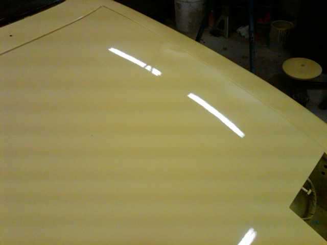

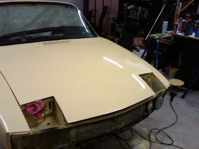

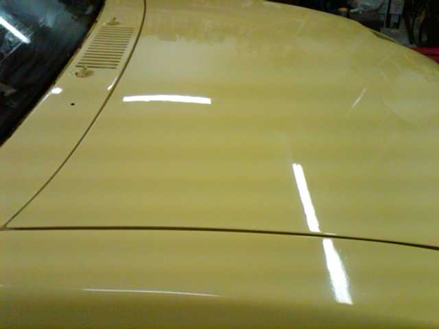

I'm really happy with how the paint is coming out, Man I forgot how time consuming it is to buff out paint, especially a single stage, it is so hard to photo the shine but this is the best I can come up with.
