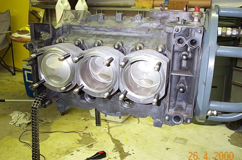

Sure, ya got 2mm of base gaskets. (IMG:style_emoticons/default/biggrin.gif)
Actually, I told that Mahle Does not consider deck height when computing compression so they'er actually .5 less than advertised......so 1 mm of base gasket *might* get you there.
Here's what the dome on my 10.4:1s look like....less than the Mt. Everest on those.
The RSR had a different size combustion chamber than the SC....smaller by 13ccs. Talk to Mr. Weiner, I'm out of my depth.
