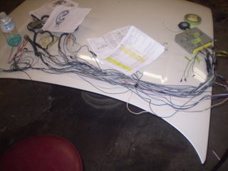

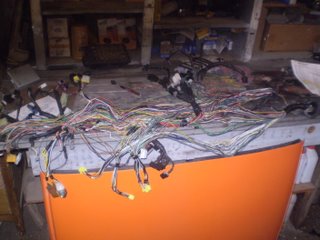

The wiring harness was something that I had to turn my brain off for. It was really hard to cut all those wires hoping the whole time that I was doing it right. I'll know pretty soon if all was done correctly.
The start of a long and tedious process.
After all the unnecessary wires were gone.

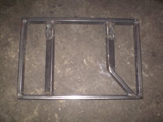

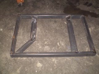

Then I was able to start on my motor mount. I had to avoid the oil filter and exhaust manifolds because the mounts on the 3.3 are towards the back of the engine and I am using the stock mounting points on the 914.

basaltblack   Are you going to weld that mounting bar to the st...   Mar 20 2010, 03:01 PM
