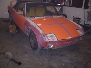

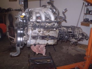

The progect started with the plan to rebuild the 1.8 and just get it running. Then with the long list of parts and prices I decided to go a little bigger with a subaru svx 3.3.

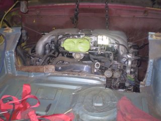

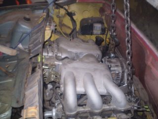

Click to view attachmentClick to view attachmentThe motor and tranny fit really well considering going from a 1.8 to a 3.3. The tranny mounts worked without any modification and with plenty of room to spare at the front of the motor.

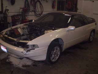

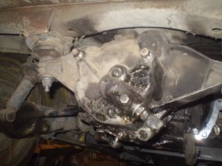

Click to view attachmentClick to view attachmentThe doner cars.

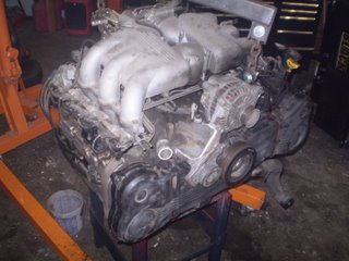

Click to view attachmentClick to view attachmentClick to view attachmentHad to make some room in the trunk to clear the throttle bodies and brackets. I plan on boxing it all in to house the harness and air intake.

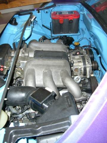

Glad to see this thread. It got me motivated to go to the garage and work on my EG33 914 conversion.
I've been building a new DIYPNP megasquirt fuel injection control for it and finally got it running today. I'm using all of the stock subaru sensors and running a wasted spark.
Click to view attachmentBob

QUOTE(BIGKAT_83 @ Jan 2 2010, 03:50 PM)
I've been building a new DIYPNP megasquit fuel injection control for it and finally got it running today. I'm using all of the stock subaru sensors and running a wasted spark.
yeah! Bob got it running a few hours ago! Congradulations
It looks like your using the stock airbox. How are you planning on ducting the air to it? I dont know if i am going to put flares on it yet so if I do, then I will have the air scoops in them. But I just started so its a while off yet. Keep me posted on your project.

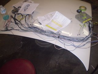

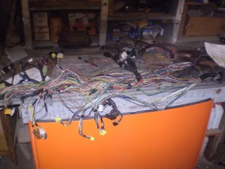

The wiring harness was something that I had to turn my brain off for. It was really hard to cut all those wires hoping the whole time that I was doing it right. I'll know pretty soon if all was done correctly.
The start of a long and tedious process.
Click to view attachmentAfter all the unnecessary wires were gone.

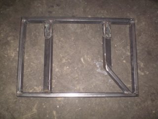

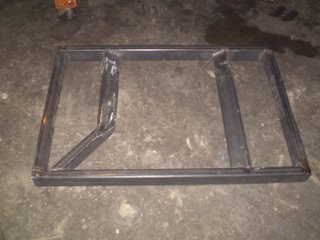

Click to view attachmentThen I was able to start on my motor mount. I had to avoid the oil filter and exhaust manifolds because the mounts on the 3.3 are towards the back of the engine and I am using the stock mounting points on the 914.

Are you going to weld that mounting bar to the stock mount bar? I am doing the same conversion but still at the car on rotisserie rust repair stage. Also on the wiring I have the pinouts from all data but can't decifer what all the numbers to wires mean. Did you just follow the wires to the end and see what they plugged into?

Hey guys sorry that i havent posted any info in a while. I have been busy with work, working on my Busa and building a Tl1000r for my dad. So here are some answers for you. I got the wiring diagram from small car performance. They do the subie 3.3 in a vanagon and also have a chip for the motor that helps with stalling issues. The motor mount that i built is going to bolt to the stock points on the body. It looks a little overbuilt but the 3.3 mounts are really close to the exhaust manifolds. As for cutting so much of the trunk out, some of it has to come out to clear the throttle bodies to get the oil pan the ground clearance that i wanted. Then i am using the stock airbox and mass air flow sensor so more of the trunk needed to go. Im sure that there are other options for routing the airbox than im doing. If the car turns out the way that i want it to i plan on doing the subie tranny in the future but for now I have a couple of 901's to use.
