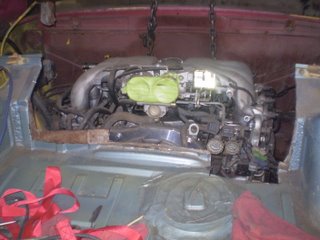

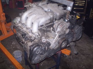

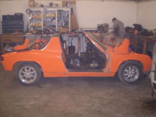

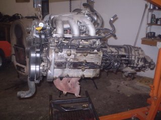

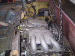

The progect started with the plan to rebuild the 1.8 and just get it running. Then with the long list of parts and prices I decided to go a little bigger with a subaru svx 3.3.

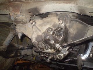

The motor and tranny fit really well considering going from a 1.8 to a 3.3. The tranny mounts worked without any modification and with plenty of room to spare at the front of the motor.

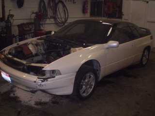

The doner cars.
Had to make some room in the trunk to clear the throttle bodies and brackets. I plan on boxing it all in to house the harness and air intake.
Everything is still in the early stages so I could use any and all help.
