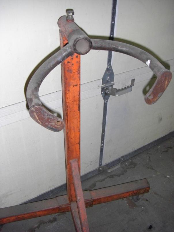

Will your adapter mount to this DR.? the holes are about 8.5" apart.

QUOTE(swood @ Jan 1 2010, 08:19 PM) *
I have built 2 motors on a stand exactly like that one. its not the best out there, to be sure. But no adapter is needed.

Mark Henry   Wood, isn't that a VW engine stand? you are do...   Jan 7 2010, 10:11 AM
