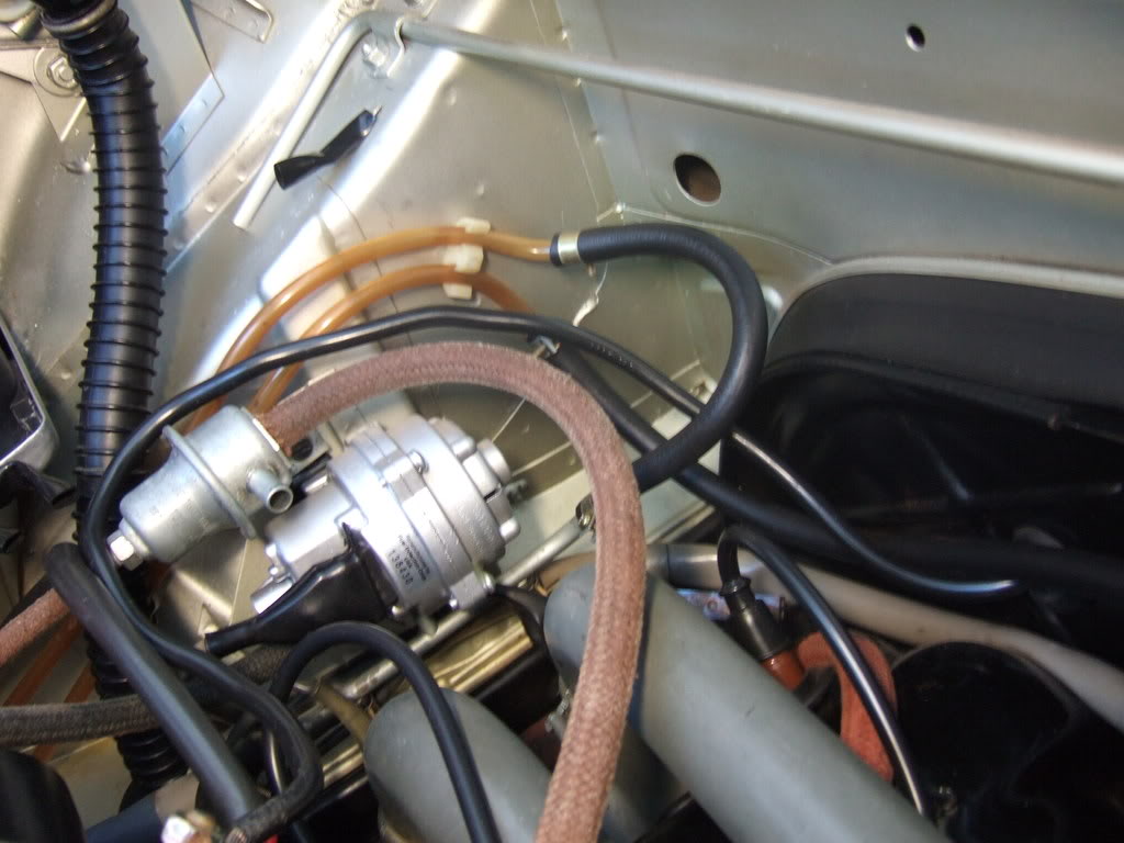

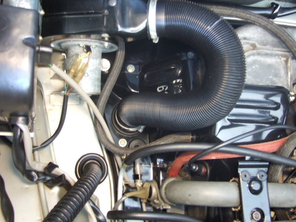

Jeff Bowlsby   I had some intake runners and the full exhaust sys...   Nov 19 2009, 02:42 PM
tod914   Thanks Jeff. By chance could you post a picture? ...   Nov 19 2009, 03:27 PM
Jeff Bowlsby   Here you go Tod. These are the cermaic coating Te...   Nov 22 2009, 04:15 PM
Pat Garvey   Here you go Tod. These are the cermaic coating T...   Nov 22 2009, 06:37 PM
Jeff Bowlsby   I can see why you might say that Pat, looking at t...   Nov 23 2009, 02:23 PM
Jeff Bowlsby   Here are 2 from 1973 cars:   Nov 23 2009, 02:33 PM
Tom_T   Here are 2 from 1973 cars: Mine are the same as ...   Nov 24 2009, 09:06 PM
Jeff Bowlsby   And two from 1974 cars:   Nov 23 2009, 02:34 PM
tod914   Jeff thanks for posting. I picked up the two offe...   Nov 23 2009, 04:50 PM
