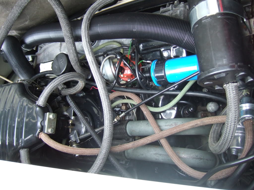

Jeff Bowlsby   I had some intake runners and the full exhaust sys...   Nov 19 2009, 02:42 PM
tod914   Thanks Jeff. By chance could you post a picture? ...   Nov 19 2009, 03:27 PM
Jeff Bowlsby   Here you go Tod. These are the cermaic coating Te...   Nov 22 2009, 04:15 PM
Pat Garvey   Here you go Tod. These are the cermaic coating T...   Nov 22 2009, 06:37 PM
Jeff Bowlsby   I can see why you might say that Pat, looking at t...   Nov 23 2009, 02:23 PM
Jeff Bowlsby   Here are 2 from 1973 cars:   Nov 23 2009, 02:33 PM
Tom_T   Here are 2 from 1973 cars: Mine are the same as ...   Nov 24 2009, 09:06 PM
Jeff Bowlsby   And two from 1974 cars:   Nov 23 2009, 02:34 PM
tod914   Jeff thanks for posting. I picked up the two offe...   Nov 23 2009, 04:50 PM

tod914   Here's more reference of original paint runner...   Jan 7 2010, 12:34 PM
tod914   1975 2.0   Jan 7 2010, 12:36 PM
tod914   2 ebay cars, unknown years.   Jan 7 2010, 12:37 PM
Tom_T   2 ebay cars, unknown years. :rolleyes: Loo...   Jan 7 2010, 02:48 PM
Tom_T   :type: Check here at about 1/2 way down for the e...   Jan 7 2010, 02:44 PM
