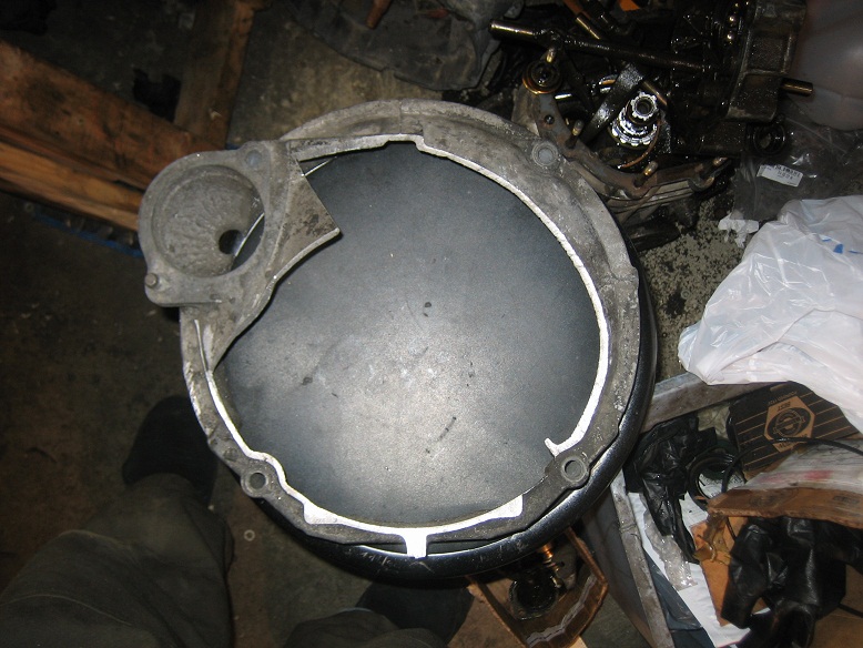

Here is a pic of a raw one. I need to remove the excess which creates nice flat spots for bolting.

codices   It depends upon the attachment brackets you have w...   Jan 1 2010, 05:28 PM
Vacca Rabite   Depends. If you are only taking the engine down to...   Jan 1 2010, 05:47 PM
McMark   :agree: The 'V8' stand works well enough ...   Jan 1 2010, 05:53 PM
type47   Consider the adapter "half-circle" offer...   Jan 1 2010, 06:16 PM
Black&White   Looks like I need the VW adapter. Dose any one kno...   Jan 1 2010, 06:34 PM
Dr Evil   I have adapters that I make from the bell housings...   Jan 1 2010, 06:37 PM
arvcube   I have adapters that I make from the bell housing...   Jan 1 2010, 10:47 PM
bigkensteele   I have adapters that I make from the bell housing...   Jan 7 2010, 10:54 PM
swood   Will your adapter mount to this DR.? the holes are...   Jan 1 2010, 07:19 PM
Vacca Rabite   Will your adapter mount to this DR.? the holes ar...   Jan 7 2010, 10:26 AM
Dr Evil   I dont see why it wouldnt. The holes in the bell h...   Jan 1 2010, 07:35 PM
swood   Just wondered how the modified bell housing would ...   Jan 1 2010, 09:03 PM
Dr Evil   I dont have a pic at the moment. I cut the bell ho...   Jan 1 2010, 09:58 PM
Dr Evil   Sorry, I spaced. I will get pics tomorrow of the a...   Jan 6 2010, 11:11 PM
Mark Henry   Wood, isn't that a VW engine stand? you are do...   Jan 7 2010, 10:11 AM
Dr Evil   Here is a pic of a raw one. I need to remove the e...   Jan 7 2010, 04:43 PM
arvcube   Here is a pic of a raw one. I need to remove the ...   Jan 7 2010, 09:31 PM
Dr Evil   It will mount to the HF unit. The best way to go a...   Jan 7 2010, 09:39 PM
Van   Build it on a table - I drilled some holes for the...   Jan 7 2010, 09:42 PM
Dr Evil   Will do. Remind me before I leave. I need to trim ...   Jan 7 2010, 10:59 PM
