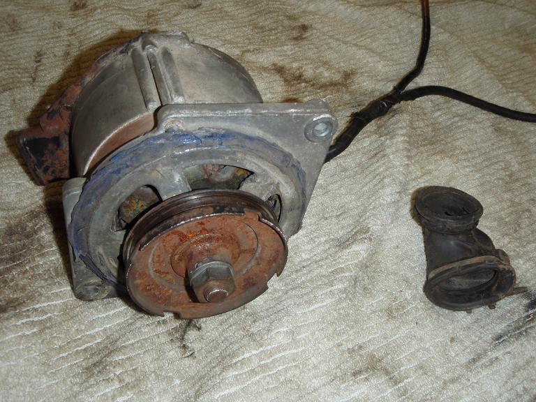

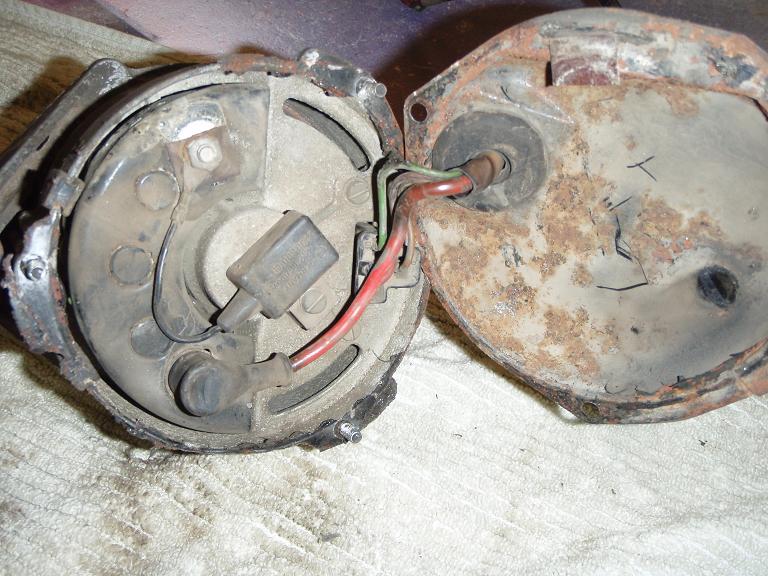

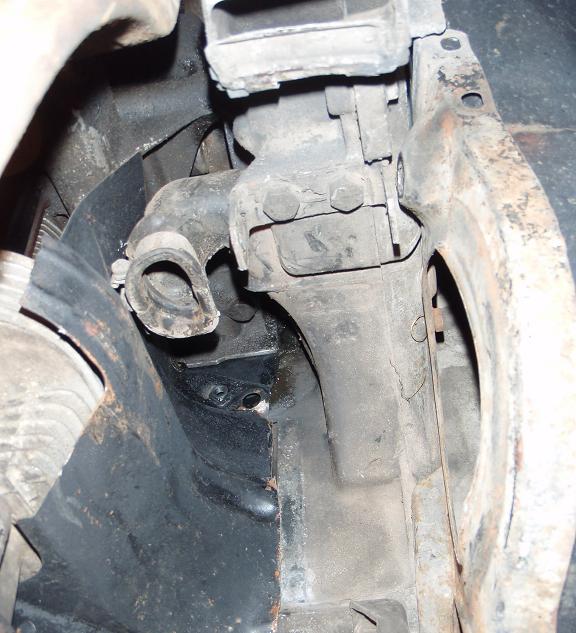

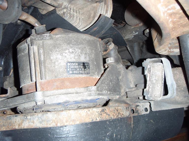

figured i would post the pics of my swap. Basically I orderd a VW bus 75 amp alternator brand new. Got it wound to 120 amps, got Jeff Bowlsby to make me a custom harness with 2 runs of 8guage to handle my maddness. Got a few much needed parts from Detoxcowboy and my plastic seal from the samba.
have a look. (IMG:style_emoticons/default/icon_bump.gif)
Picture of the original 55 amp alternator in its snug home
Picture of the original 55 amp alternator stolen from its home
Pics of the alternator, inside and out and the krusty boot

jsayre914   figured i would post the pics of my swap. Basicall...   Jan 12 2010, 09:46 AM
jsayre914   Picture of the old harness and the new harness vs...   Jan 12 2010, 09:48 AM
jsayre914   side by side comparison 55 amp vs 120 amp :chow:   Jan 12 2010, 09:51 AM
jsayre914   Then to get the pullys off it is a little tricky, ...   Jan 12 2010, 09:53 AM
jsayre914   Now that they match, I painted the pulley so it wo...   Jan 12 2010, 10:00 AM
jsayre914   The Bolt was a little tight so had to be adjusted ...   Jan 12 2010, 10:05 AM
jsayre914   The Final result, looks almost stock and fits exac...   Jan 12 2010, 10:07 AM
jsayre914   Now I should have just enough power to listen to m...   Jan 12 2010, 10:09 AM
SirAndy   Any way you could have kept the cooling fins? Woul...   Jan 12 2010, 02:14 PM
detoxcowboy   Any way you could have kept the cooling fins? Wou...   Jan 12 2010, 03:19 PM
