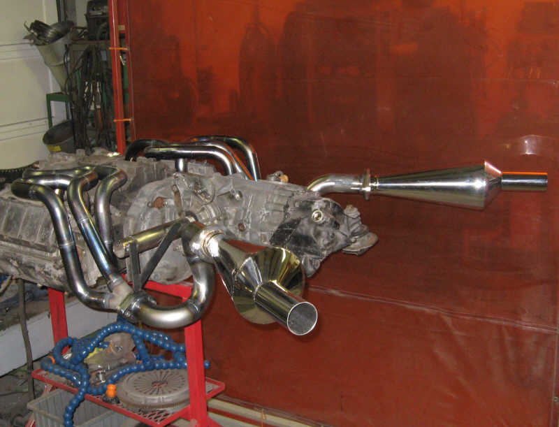

First prototype of a critical component:

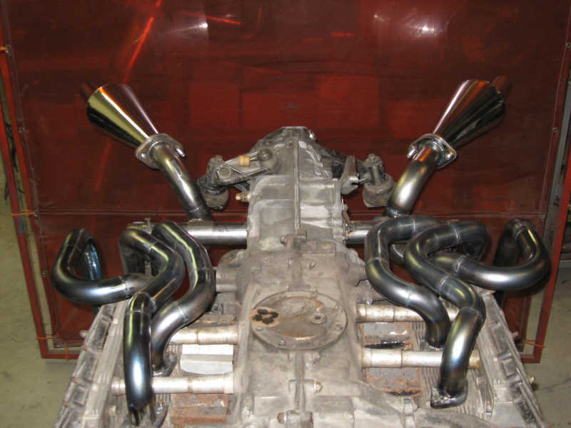

Here is the racetrack version of the new header. (IMG:style_emoticons/default/smile.gif)

KevinP   Chris, I have always wondered why we have had to ...   Dec 10 2009, 08:33 AM

JmuRiz   So this is for an exhaust scavenging header like y...   Dec 10 2009, 10:24 AM
Racer Chris   So this is for an exhaust scavenging header like ...   Dec 10 2009, 11:55 AM
JmuRiz   Cool stuff, can't wait to see the results, in ...   Dec 10 2009, 01:14 PM
Travis Neff   Are you planning to do any pre-post dyno work?   Dec 10 2009, 08:06 PM

Racer Chris   Here's a view of the partially built protptype...   Dec 12 2009, 08:45 AM
Racer Chris   Muffler's done. It will fit behind a WEVO 915.   Dec 15 2009, 06:23 PM

Mark Henry   The firing order of a six essentially means the...   Dec 16 2009, 02:38 PM
Mark Henry   Is there a reason that most N/A systems are done (...   Dec 16 2009, 05:09 AM

Racer Chris   Here's what the new muffler will look like wit...   Dec 16 2009, 06:53 PM

Racer Chris   On the six cylinder front: Yesterday I realized th...   Dec 17 2009, 12:36 PM
9146986   So why up and over the half shafts? Not being cri...   Dec 18 2009, 12:55 PM
Racer Chris   So why up and over the half shafts? Nathan is p...   Dec 18 2009, 03:23 PM
JmuRiz   I'm guessing it has to do with the desired len...   Dec 18 2009, 01:07 PM
Racer Chris   Here is the racetrack version of the new header. :...   Jan 14 2010, 05:41 PM
ClayPerrine   Chris, I can't do what you do, but I do have ...   Jan 14 2010, 09:26 PM
Racer Chris   It may be the angle of the shot though..... Its ...   Jan 14 2010, 10:50 PM
