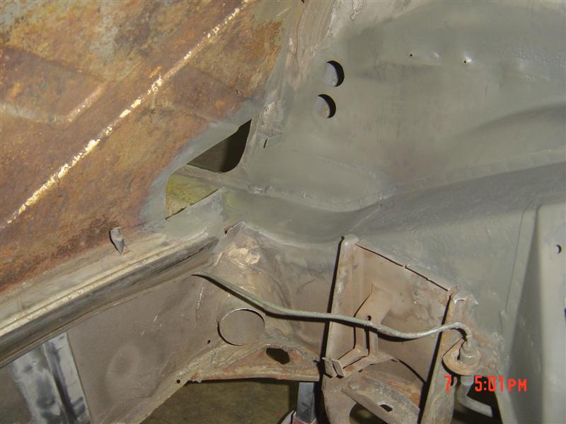

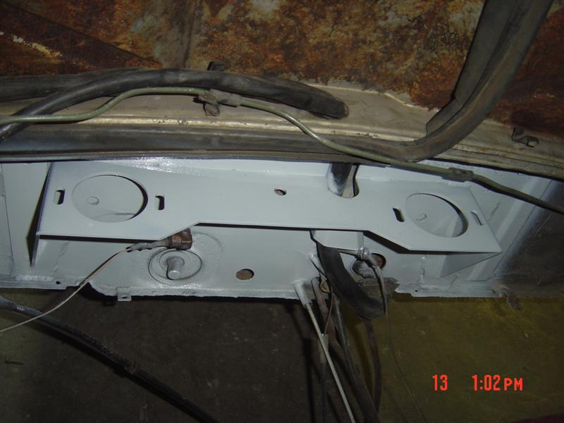

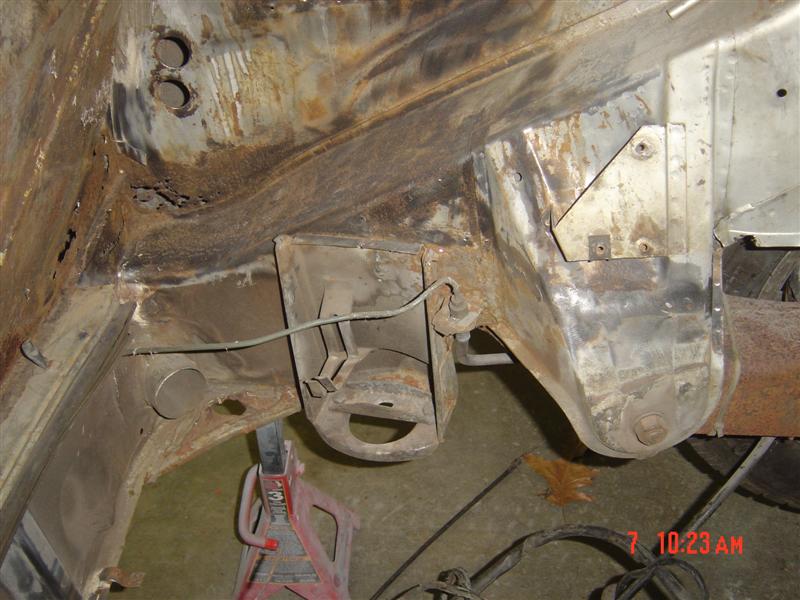

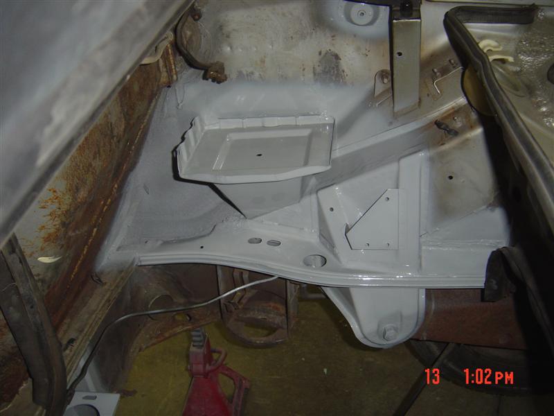

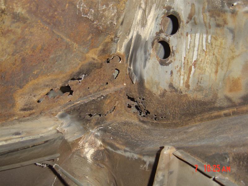

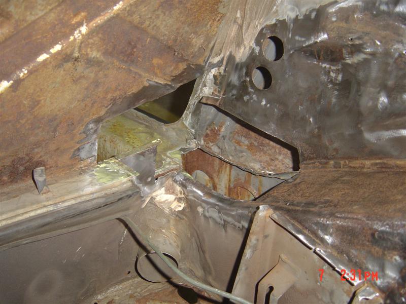

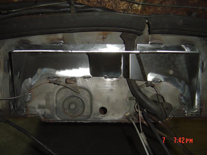

I was doing a rear trunk yesterday and today, and knowing how everyone likes to see every sqaure inch of a naked teener (IMG:style_emoticons/default/unsure.gif) I shot some pics of a trunk cut apart. I forgot to take pics of the old trunk cut out before welding in the new, but I figured the " plugs " were the more interesting prts anyway (IMG:style_emoticons/default/confused24.gif) Also note the replacemetn panels do not have the holes cut out. If you don;t care about the originality, I personally would leave them be, one less place tro trap water (IMG:style_emoticons/default/blink.gif) I went ahead and put these in because I wanted to find out exactly how much more time it would take to do them. Now I need one of the expensive seam seal guns to get the finish just right My cheapo 150.00 gun wouldn't get it quite perfect (IMG:style_emoticons/default/dry.gif) Coat of selaer tomorrow and I move on to the next hole....hell hole.........

Yep hell hole is done and car is gone. Moving onto the next one this week.
