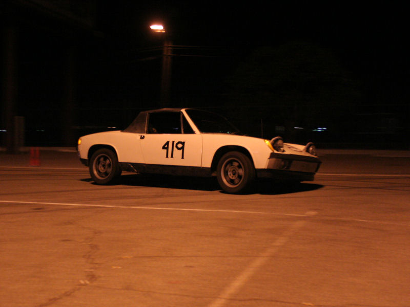

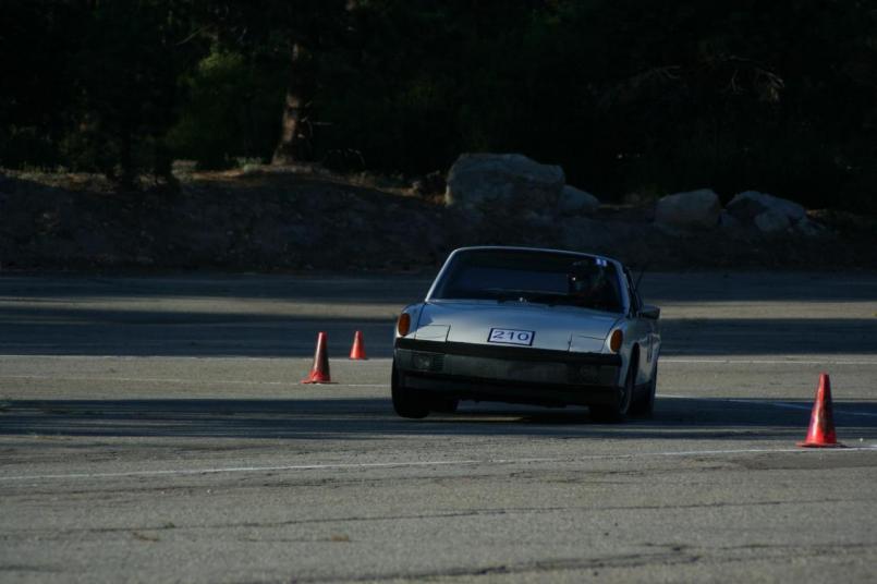

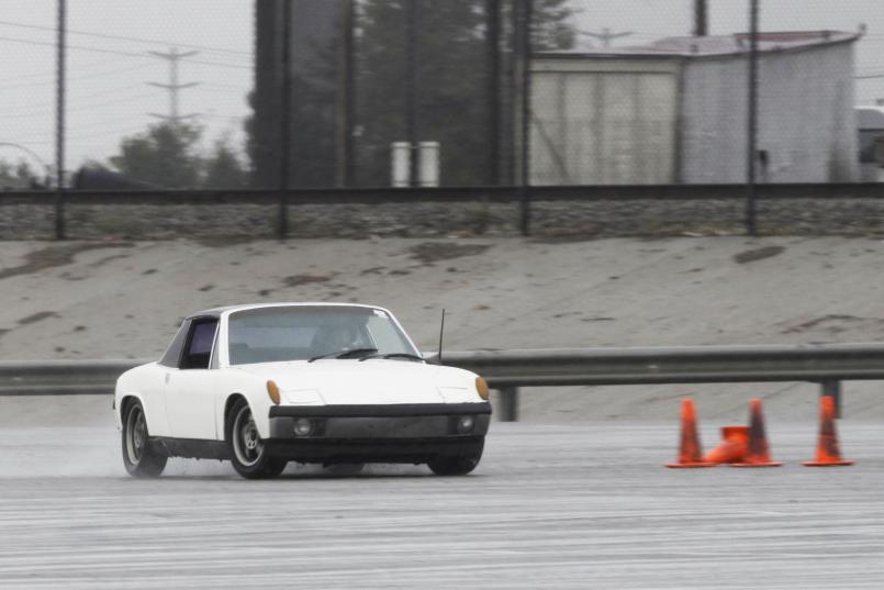

Second, the 914's 'legendary' handling isn't nearly as good without sways. Even if it's not going to be a track car, swaybars make all the difference in the world and are totally worth the effort. My '70 didn't have sways from the factory, and I got a good two or so years driving with the mad body roll. I thought it was great until I saw pictures of myself at an autocross. I built me a front Speedway Engineering bar and stiffened up the rear springs and it's amazing now! Do it! Original: ![]() Front swaybar ONLY, and stock rear springs Front bar, 200 lb springs in the rear, and Konis on all fours. If you mount both front and rear bars with stock springs, you balance should be close, your ride shouldn't be too rough, and body roll will be minimal. My $.02 Enjoy the disease! (IMG:style_emoticons/default/driving.gif) Mark D. |
