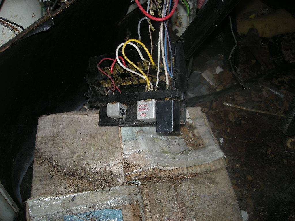

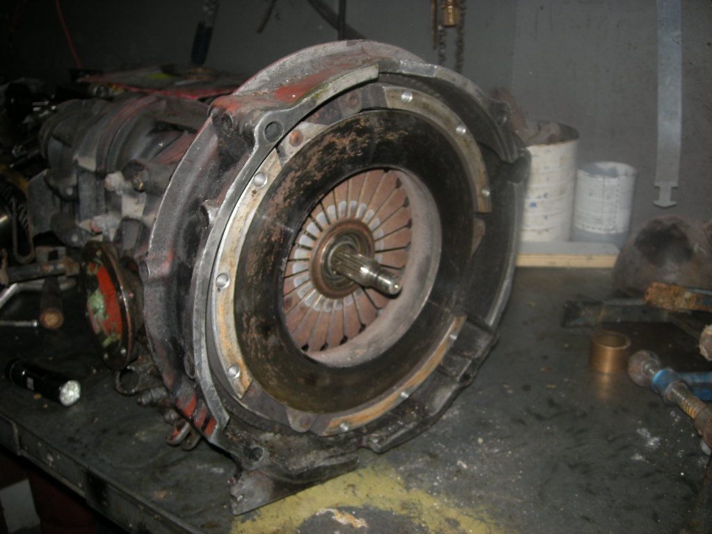

Here's a pic of the pressure plate I can't figure how to get pressure off of it to spin the bearing to the release position. It's the same type of tranny as the one you rebuilt at the clinic. I do know how.... if it was attached to an engine and is removed from an engine with a fly. This I can't figure out...

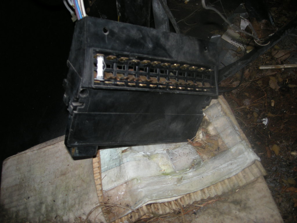

Also Dr. Evil here's a couple of pics of the bus fuse panel, is it what you want?

Mark Henry   I have a clutch out of a 71 that I can have real c...   Jan 20 2010, 07:33 AM
Dr Evil   If I understand you correctly, just pull the flywh...   Jan 20 2010, 11:53 AM
SirAndy   If I understand you correctly, just pull the flyw...   Jan 20 2010, 12:02 PM
Mark Henry   Nope, haven't had a fall down drunk since you ...   Jan 20 2010, 12:06 PM
Dr Evil   Yup, thats what I want. As for your pressure plate...   Jan 20 2010, 12:30 PM
Mark Henry   It is a 911 71 (I think) PP and was told by the lo...   Jan 20 2010, 12:36 PM
SLITS   As a temporary fix, just remove the circlip & ...   Jan 20 2010, 12:38 PM
Dr Evil   I am not sure if it will work for a 3.0 or not as ...   Jan 20 2010, 12:39 PM
Mark Henry   I can't see a circlip and the pivot bolt trick...   Jan 20 2010, 12:55 PM
sixnotfour   poke a screw driver down to the throw out bearing ...   Jan 20 2010, 01:41 PM
SLITS   poke a screw driver down to the throw out bearing...   Jan 20 2010, 05:46 PM
Mark Henry   I know how it comes out normally, I did remove the...   Jan 20 2010, 10:42 PM
SLITS   Need the engine and flywheel on it OR some kind ...   Jan 21 2010, 10:12 AM
