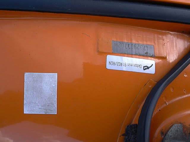

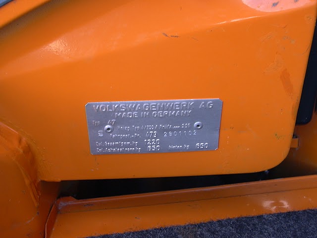

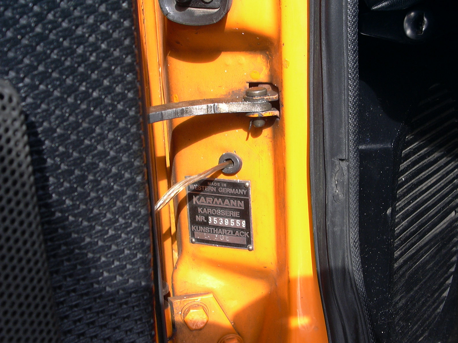

FYI Y'all - Here is 01102's Chassis plate #3539559 for a build date the week & a day prior to mine - so they were probably neighbors on both the Karmann & VW final assembly lines - despite the VIN stickers' respective Build Dates of 9/72 for this one & 8/72 for mine! Who knows - maybe mine was in front of the line at VW ?? (IMG:style_emoticons/default/confused24.gif)
- only adding to the mystery! (IMG:style_emoticons/default/dry.gif)
Karmann Plate, Front Trunk VIN Plate & Body Stamp for VIN 4732901102:
> Note that the Door VIN & 9/72 Build Date Sticker was previously posted above.
