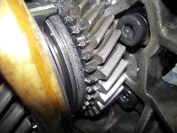

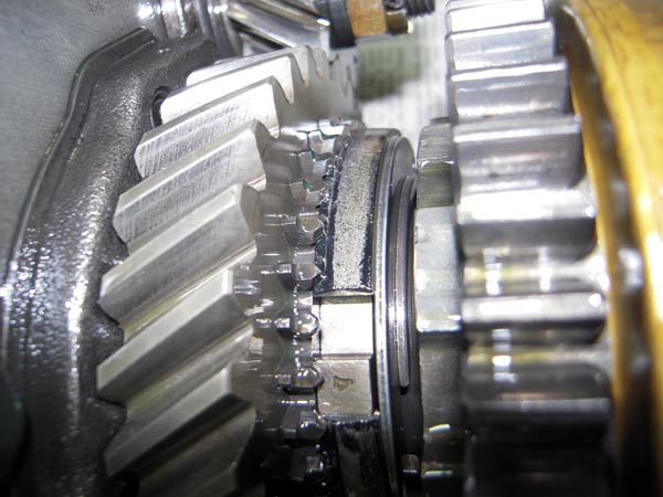

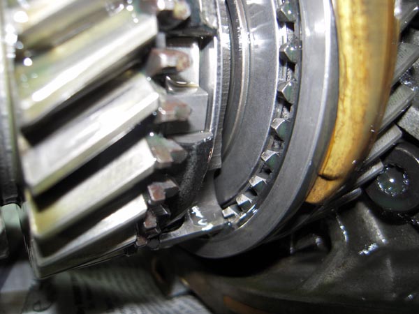

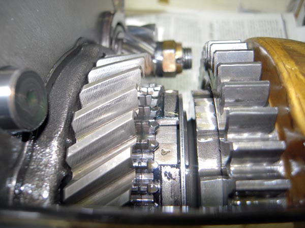

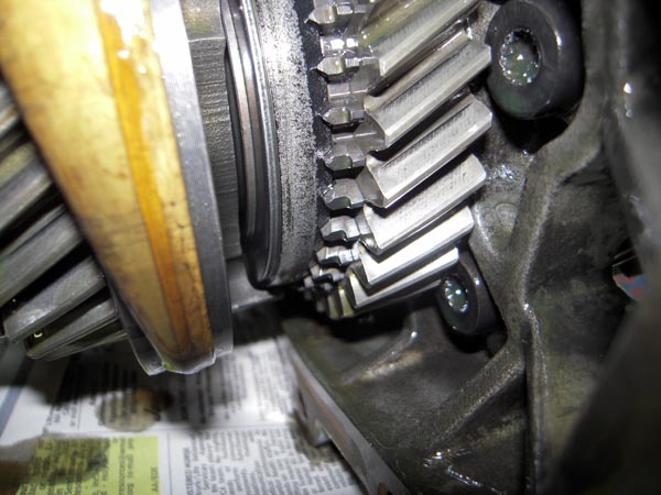

Here are pics of the 2nd gear dogteeth:
Here is the 2nd/3rd slider from the 3rd gear side:
Here is 1st gear:
