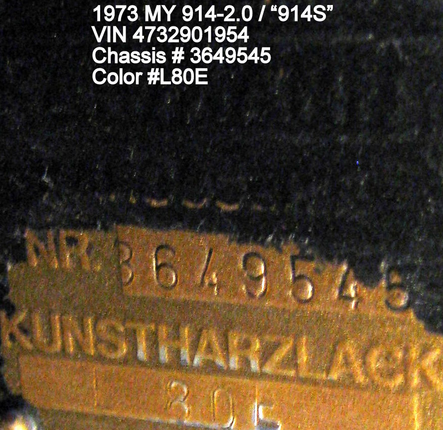

Okay folks,

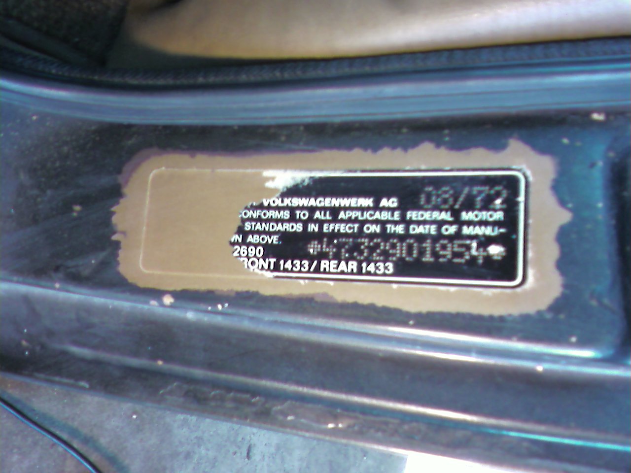

I've owned my early-73 MY 914-2.0 (914S for Pat G. (IMG:style_emoticons/default/biggrin.gif) ), and I looked at the VIN label on the driver's door jamb, but the build date could either be an "8" but missing one of the "punch-dots" in the left side of the lower loop, or a "9" with an "extra dot" (& don't ask about the COA - no help there).
... so which is it ???? (IMG:style_emoticons/default/confused24.gif)
I'm also aware of another 73 MY VIN 01102 built 9/72, & another on here VIN 01654 built 8/72 IIRC - & both are earlier VINs than mine - so did they build VINs out of date order?? (IMG:style_emoticons/default/confused24.gif)

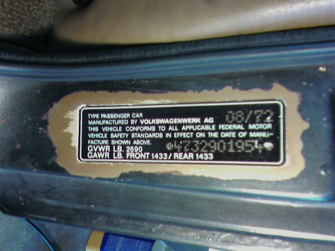

My VIN Door Jamb Label:

Tom, sorry I'm late to the party, and thanks for the PM.
Yours is definitely an 08/72 build. There does seem to be an anomalous number of 09/72 dates on the compliance decals prior to your car; from 1017 to 1400 I have a string of 09/72. I know that in the 1960's the 911's were not completed in VIN order, but I was not aware that the 914 was built out of order. The early 1973 seems to be the only time that the compliance decal dates were out of order month-wise. The also seems to be some interesting things occurring in the chassis numbers.

Thanx Dave & to Sixerdon for reminding me of the chassis dating methodology!
ALL - the continuing oddity with my 73 914S - is that it has a 8/72 build date as decided above, with a date code chassis number which places it at the 4th day of the 36th week of 1972 & #45 built on that day.
However, in looking at the 1972 calendar - that placed it as the Chassis Built on 8/31/72 - the last day of the month - with the VIN door sticker as the same month 8/72! (IMG:style_emoticons/default/blink.gif)
Geez Louise!!! - either those Germans were really fast at trucking/rail the shell from the Karmann plant to VW's 914 final assembly facility - & then completely assembling the car on the SAME DAY!
... or they used the chassis number production date for the build date on the door label !!?? (IMG:style_emoticons/default/confused24.gif)

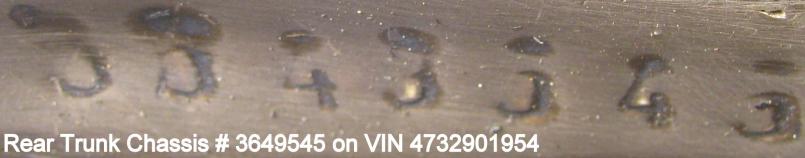

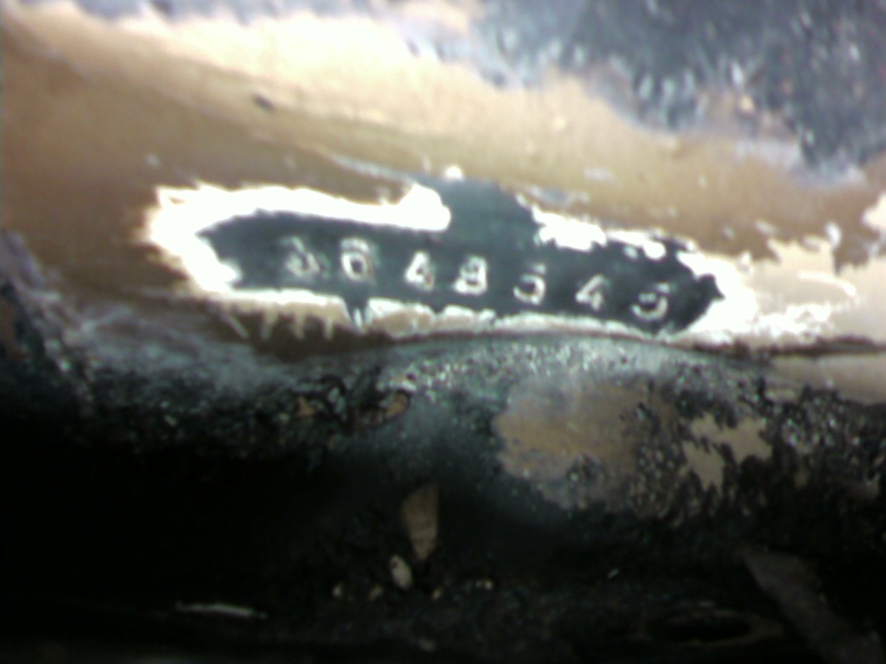

And just to quell any speculation that it's a Franken-teen Chassis - the trunk number below (although unclear with the paint over it) & Karmann door plate appear to match numbers - as both appear to be 3649545:

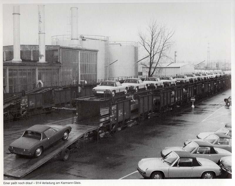

Actually, the 914s were not shipped to any VW facility for final assembly.
All 914-4 cars were fully assembled at Karmann!

Here you go, this is the lot at Karmann that i mentioned earlier. As you can see, the cars left Karmann fully assembled ...

BTW - the "missing dot" on the 8 appeared when I cleaned all the labels, stickers & stampings - all of which match-up. I also discovered that there was a 4th repaint of my 914 between the original L80E & the Gold/Bronze when I bought it in 12/75. You can see bits of it - Sahara Beige - around some of these pix below. I guess they wanted to be like Sahara Steve! .... oh wait, he had a different 914-2.0 back in 73-75! (IMG:style_emoticons/default/biggrin.gif)

More like confused ... (IMG:style_emoticons/default/biggrin.gif)
Karmann is in Osnabrück!
