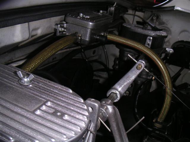

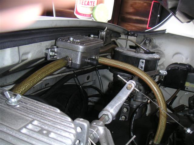

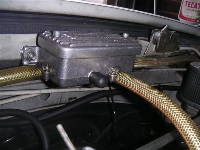

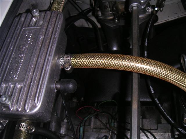

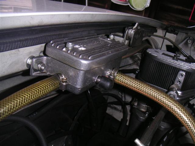

Here are a few pics of my CB/Empi setup.... seems to work fine for me.
