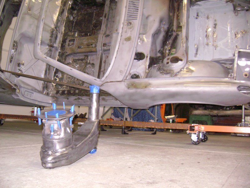

Cire   On the third picture... Where it shows the rear s...   Jan 31 2010, 08:05 PM

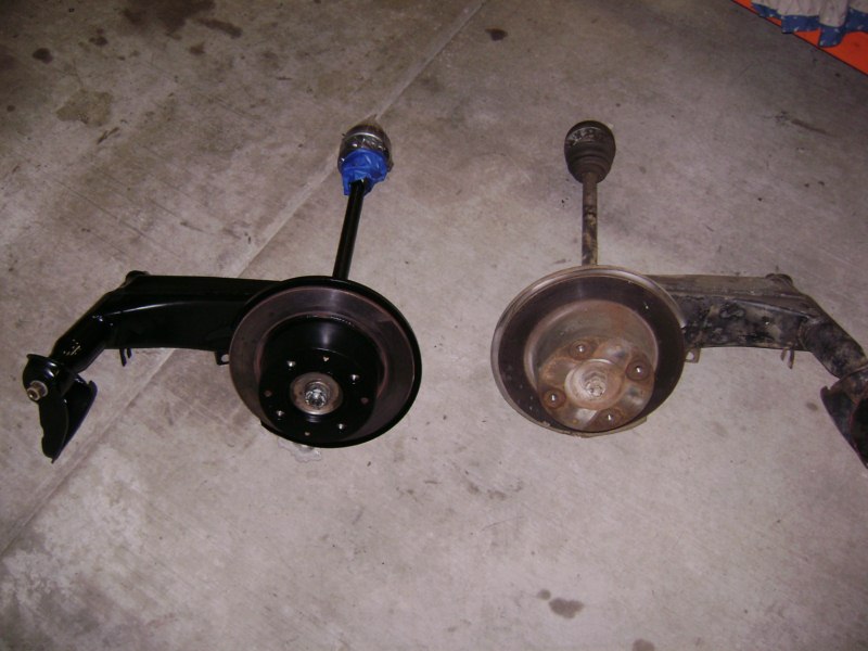

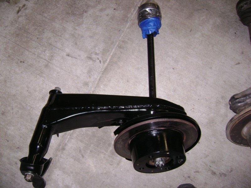

Cire   Argggg I got a 911 a arm verses a 914... Spent h...   Feb 16 2010, 07:58 AM
