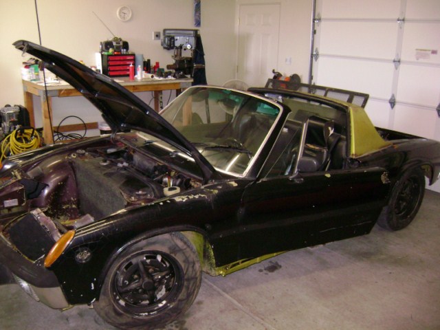

Howdy All,
This is the start of a new thread and the progress I am making on this little 914 car. First off, let me give you a little history. I had a WANTED ad in the craigslist area for Tucson and PHX. I got a call from a man stating he had a 914 that he wanted 1500 bucks for. We talked about the car. It ran, drove and he said it would make the drive to Tucson. We talked a little more and we determined he would take 1300 bucks for it. I arrange a rental car, drove to Prescott, dropped off the rental and then met the guy. It was a little rough at first but the car did start and drive... Well? No. Badly... Yes. I decided to go for it and started out the drive. It did infact make it all the way home in the heat of the day and over the mountains. = ) Anyway, so its now home, on stands and ready to begin its new life. Here are some pictures to start the thread.

Where we started....
Where we are....

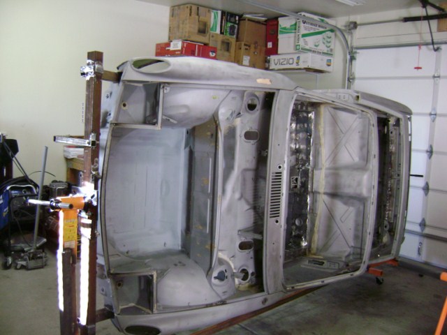

Cire   I got 90% of my welding done. Most of the holes a...   Nov 30 2009, 07:38 AM

Cire   More pictures....   Jan 31 2010, 07:54 PM
Cire   RE: Start of a new Project Thread   Jan 31 2010, 07:56 PM
Cire   On the third picture... Where it shows the rear s...   Jan 31 2010, 08:05 PM
Cire   Where we started.... Where we are....   Jan 31 2010, 08:07 PM
bcaschera   Good work!! If i were to post a where it w...   Jan 31 2010, 11:40 PM
