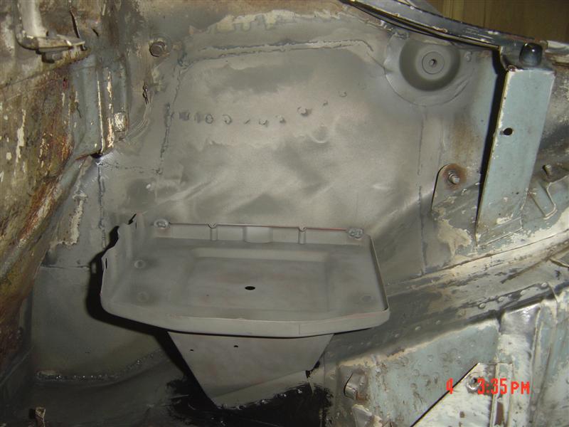

I pickep up Jim's car last weekend and got started on it today. Car will be pretty much stock. For right now I will be taking care of the metal work, after that is done I will either continue on with the body and paint, or Jim will take it back and do some of that himself. Any way, here we go (IMG:style_emoticons/default/smile.gif)

Had a little fitment issue with the inner wheelhouse, so I will give it a light coat of bondo to get rid of the seam (IMG:style_emoticons/default/dry.gif)

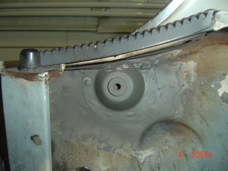

type47 In the 4th pic down where there is what looks like... Mar 17 2010, 08:25 AM

strawman Do you have any pictures showing how you fixed the... Mar 17 2010, 06:16 PM
scotty b No Geoff I don't. That was one of those times ... Mar 19 2010, 08:09 PM
type47 How did that Restoration-Design panel fit? (trunk ... Mar 20 2010, 09:05 AM
scotty b
How did that Restoration-Design panel fit? (trunk... Mar 21 2010, 06:34 PM
