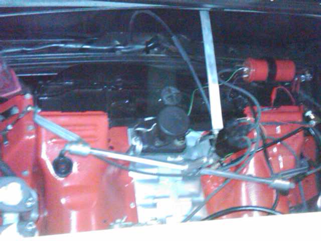

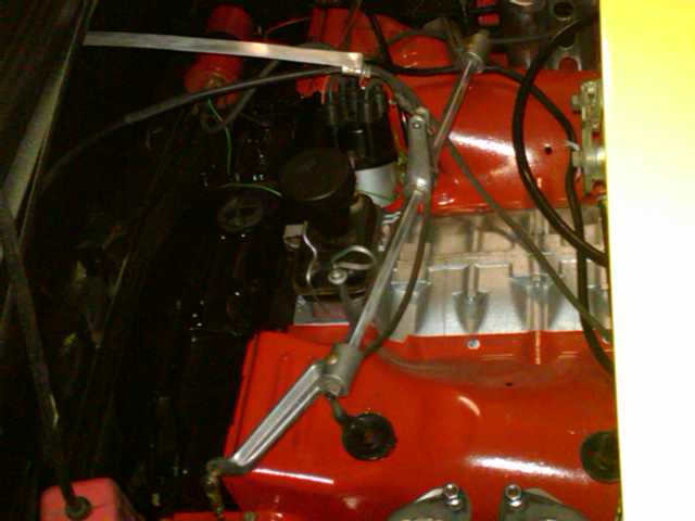

wayne1234   Progress has been SLOW.... the engine is in :D I m...   Feb 12 2010, 12:28 PM
wayne1234   RE: WOW, my "solid" car aint so solid, but now it is solid!   Feb 12 2010, 12:40 PM
wayne1234   Almost forgot I got the bumpers on!! here...   Feb 12 2010, 12:45 PM
wayne1234   Also I got the parking brake installed and working...   Feb 12 2010, 12:56 PM
