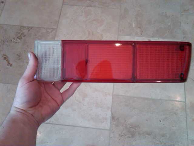

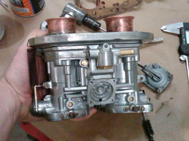

Almost forgot I got the bumpers on!! here is my tail lens, I sanded it and heve cleared it about 5 times. It looks pretty good. I just didnt want to spend the $ for new ones. And the freshly cleaned and rebuilt carbs

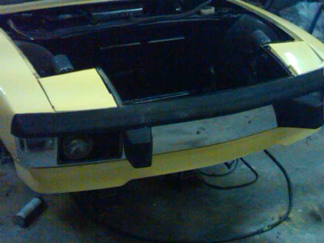

wayne1234   Almost forgot I got the bumpers on!! here...   Feb 12 2010, 12:45 PM

SirAndy   I know its a small piece , but it was curve and w...   Feb 12 2010, 02:15 PM
6freak   ton of work ...nice job .....rubber buggy bumpers ...   Feb 12 2010, 01:44 PM
wayne1234   There is always that :D I thought about it after...   Feb 12 2010, 02:26 PM
PanelBilly   Did I understand you correctly? You sanded and the...   Feb 12 2010, 02:40 PM
wayne1234   Yeah there was a crack in mine So I used the hobby...   Feb 12 2010, 03:09 PM
