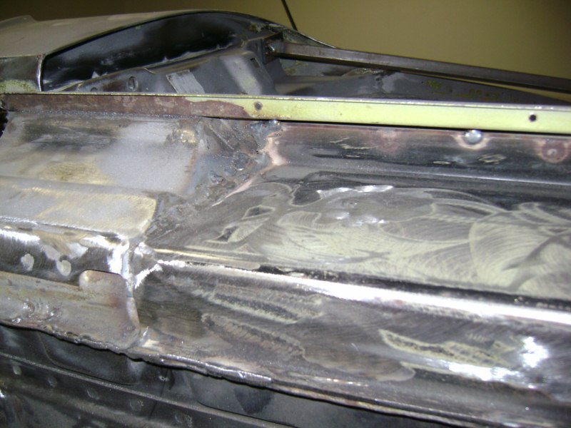

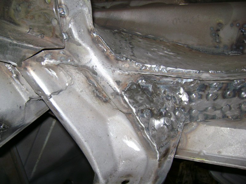

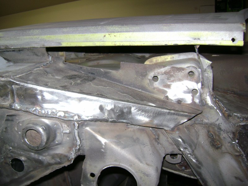

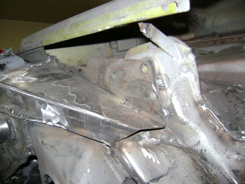

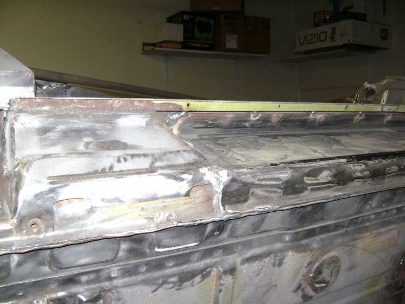

More Pictures. I got the Rob Mayeur Long Kit installed. Nice easy job and it comes out really clean. So the rear end now has the Rob Mayeur long kit connected to a Rear end stiffening kit. The upper arm that has all that extra steel isnt going to budge... I decided not to box my rear trailing arms... I figure I want the car to be more solid than I can stand and the arms be weak. That way if I slide into a curb, it might only be changing a rear trailing arm not bending the frame. Good stuff.
