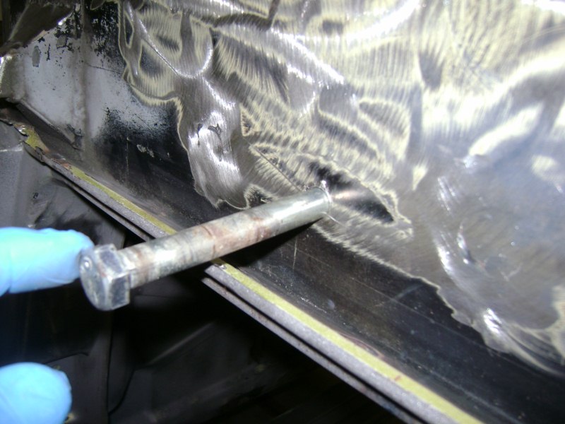

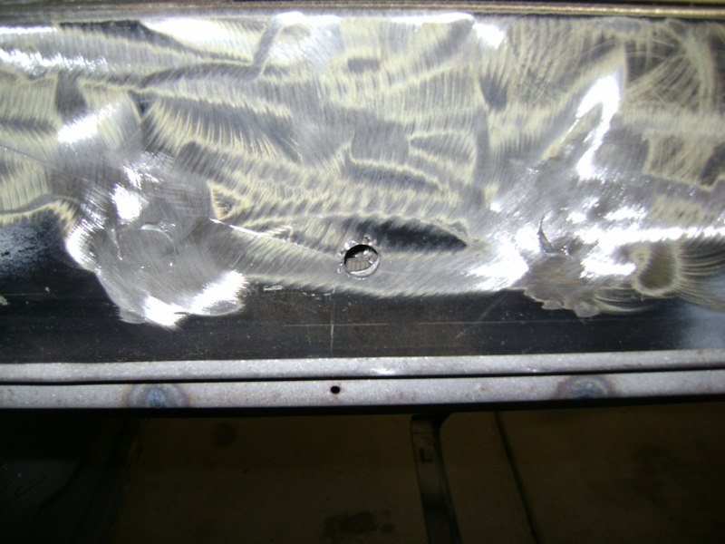

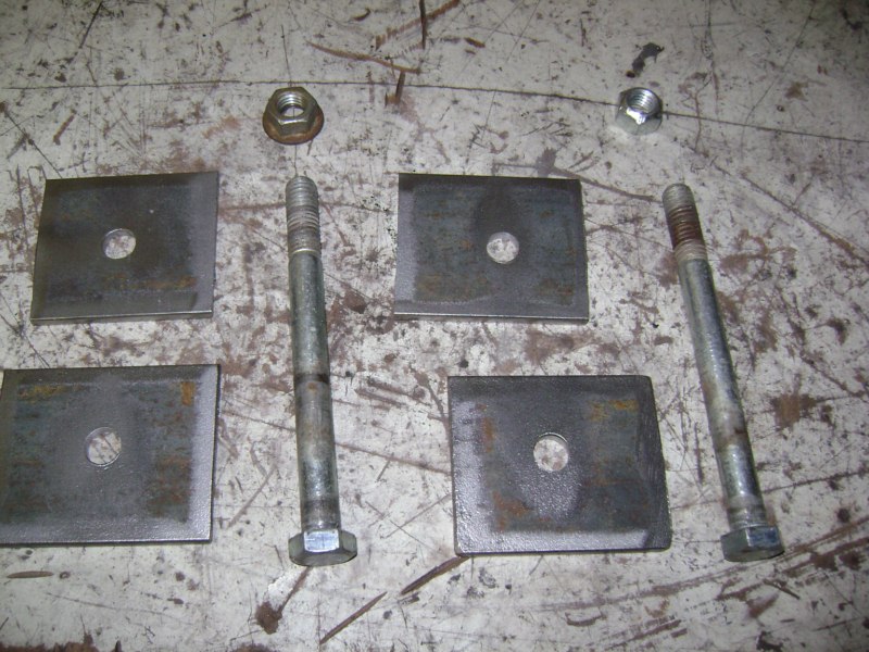

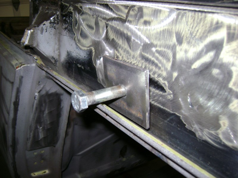

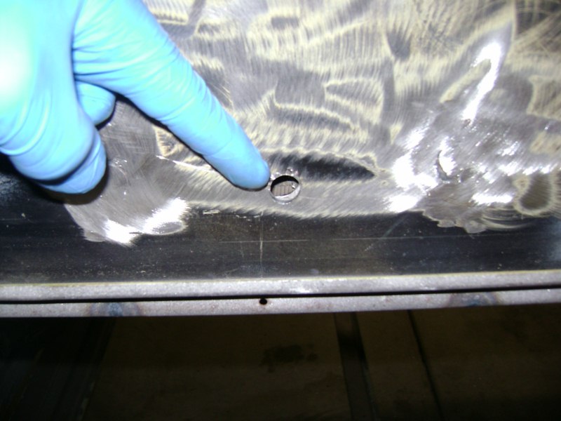

So the car has the Engman stiffening internal kit... It also has the Mayeur external stiffening kit... But there isnt anything that ties them together. We continue to add things to the outside of the longs to make them stronger but we dont do much to address the seam or the strength of the weld. I wonder if they flex? Anyway, I decided to put a bolt through the long... I put a 1/8 inch thick plate 3 X 3 and welded to it. This will ensure there is constant pressure on the long holding it together. Okay okay.. I have seen ANY other pictures of something like this and it could be silly or maybe not as effective as I dream, but its new... I will let you know how it goes if I get to drive the car before I move. = )
I also welded in a 3 inch wide plate on the bottom of the car. Here are more pics.
