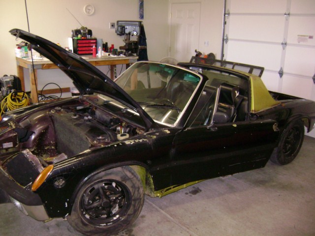

This is the start of a new thread and the progress I am making on this little 914 car. First off, let me give you a little history. I had a WANTED ad in the craigslist area for Tucson and PHX. I got a call from a man stating he had a 914 that he wanted 1500 bucks for. We talked about the car. It ran, drove and he said it would make the drive to Tucson. We talked a little more and we determined he would take 1300 bucks for it. I arrange a rental car, drove to Prescott, dropped off the rental and then met the guy. It was a little rough at first but the car did start and drive... Well? No. Badly... Yes. I decided to go for it and started out the drive. It did infact make it all the way home in the heat of the day and over the mountains. = ) Anyway, so its now home, on stands and ready to begin its new life. Here are some pictures to start the thread.

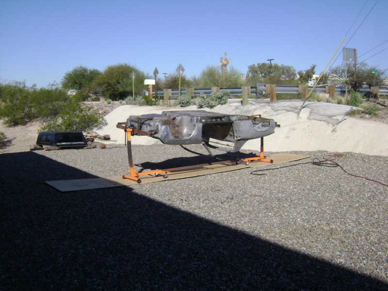

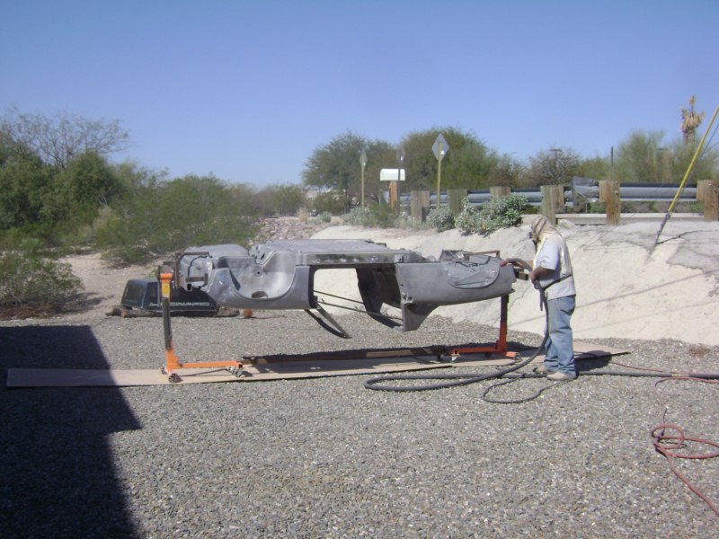

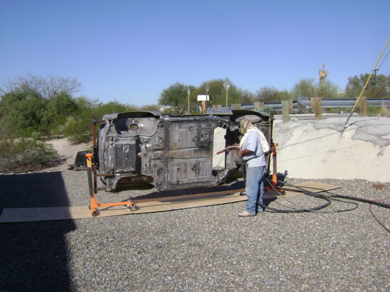

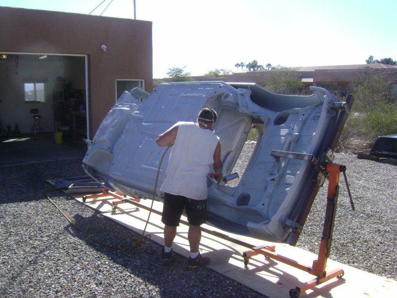

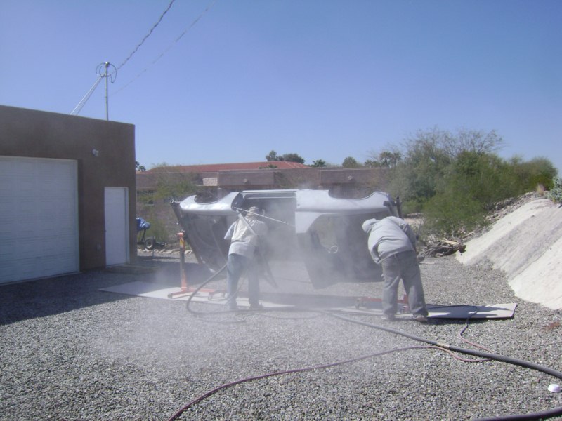

Cire   I was told that sand blasting the car is the best ...   Nov 3 2009, 06:02 PM

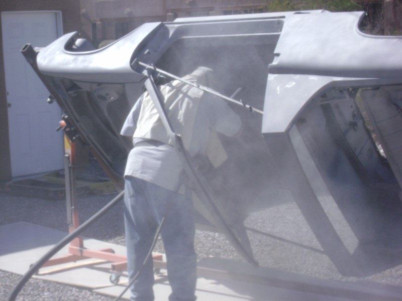

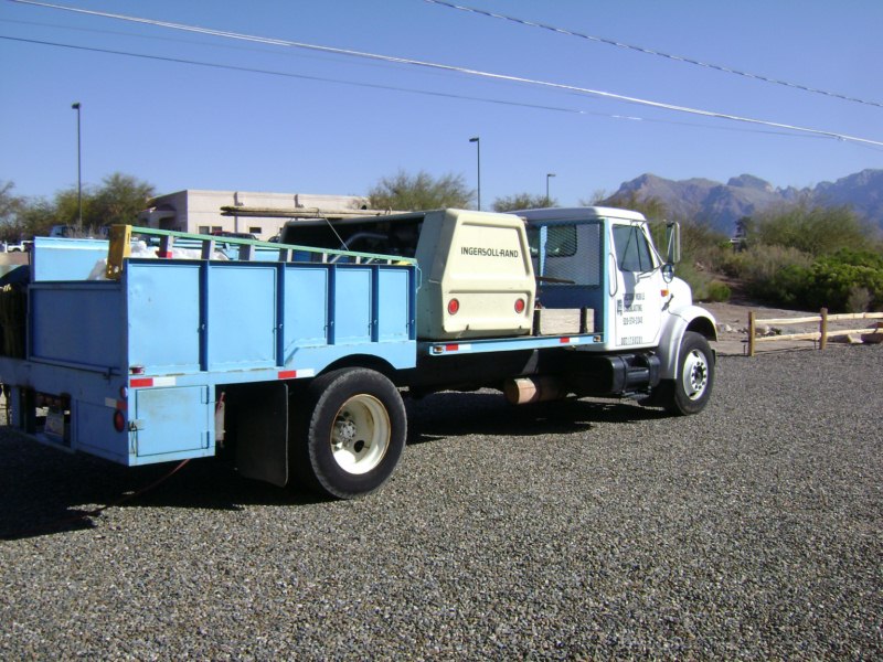

Cire   Well, I had it sand blasted. The guy came to my h...   Nov 6 2009, 06:09 PM
john grier   Hey there Eric, What you are doing is admireable. ...   Nov 6 2009, 07:09 PM

Cheapsnake   No disrespect to this forum but if you're look...   Nov 7 2009, 06:58 AM
my928s4   Nice job on the sandblasting, sure wish I had done...   Nov 7 2009, 08:57 AM

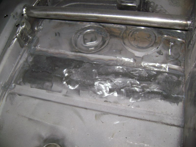

Cire   = ) Things are moving along. Are these added or ...   Nov 14 2009, 09:23 AM

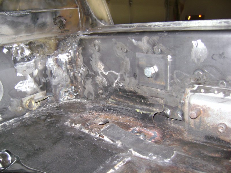

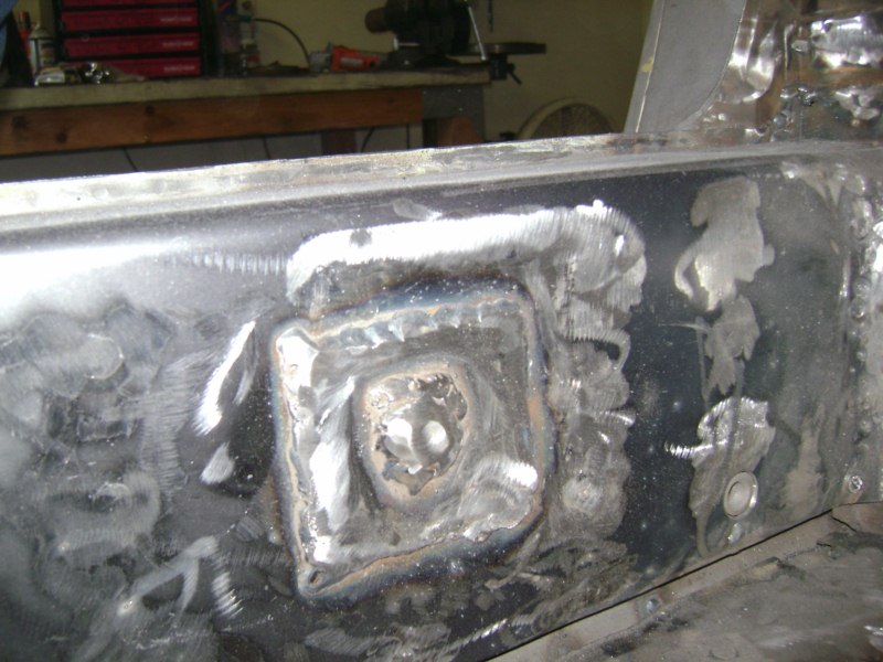

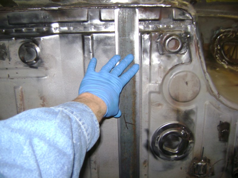

Cire   I just got the Engman Long Internal Kit installed....   Nov 14 2009, 09:26 AM

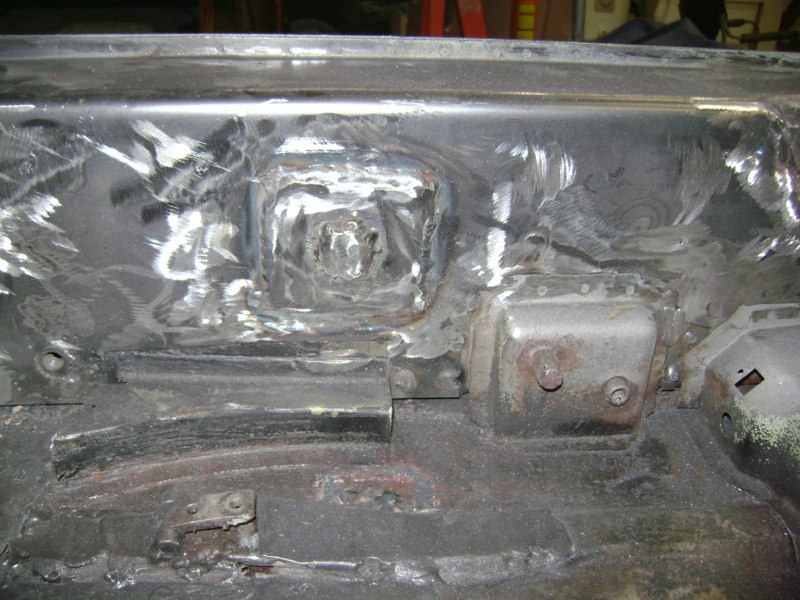

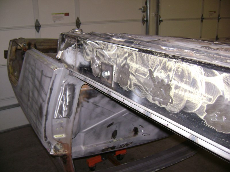

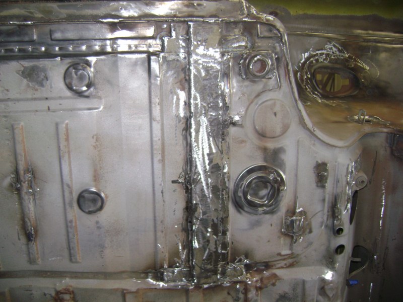

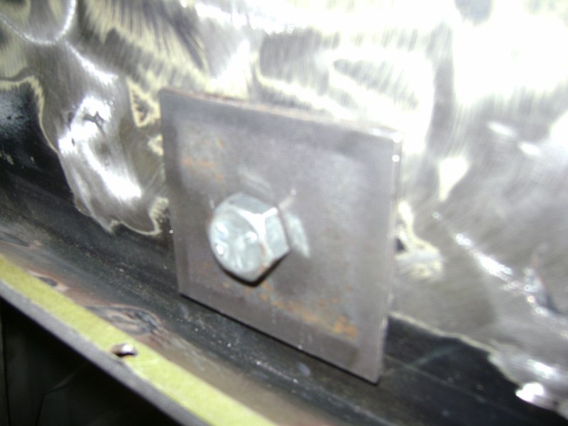

Cire   Stiffened the rear support and fixed the trunk are...   Nov 14 2009, 09:29 AM
PanelBilly   Put your door back on, RIGHT NOW. Before you go an...   Nov 14 2009, 10:29 AM

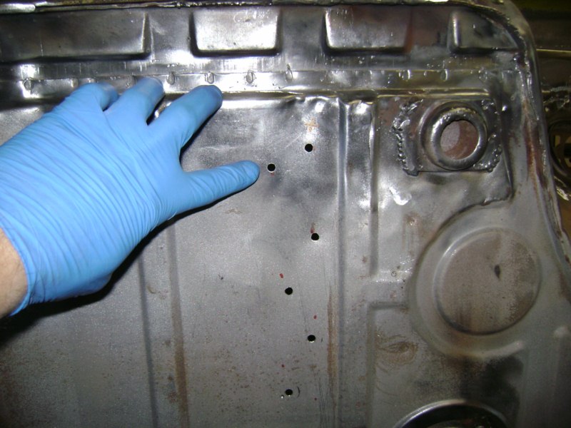

Cire   Here is the fixed hole where the AC unit used to b...   Nov 14 2009, 07:05 PM

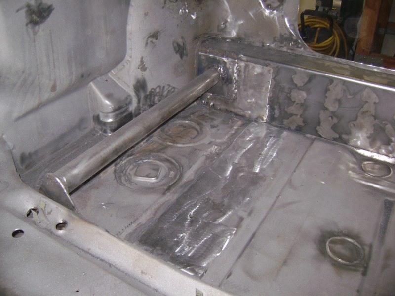

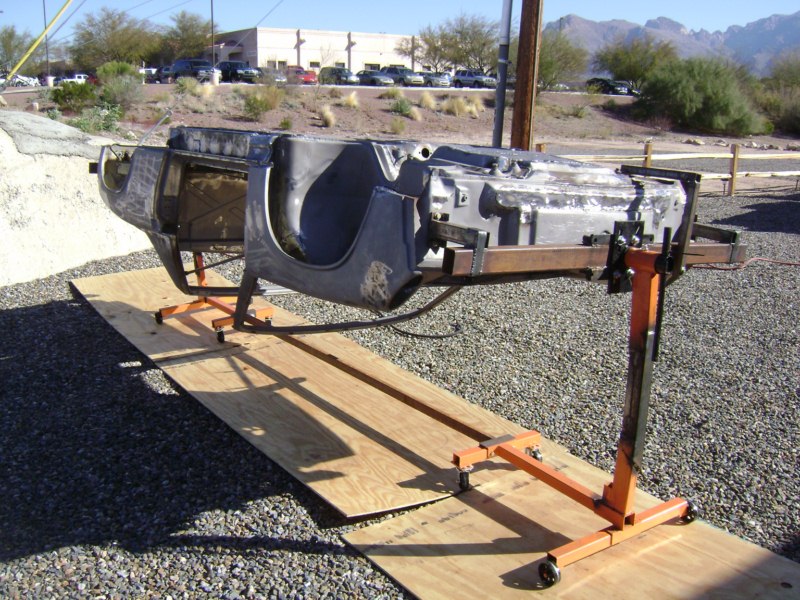

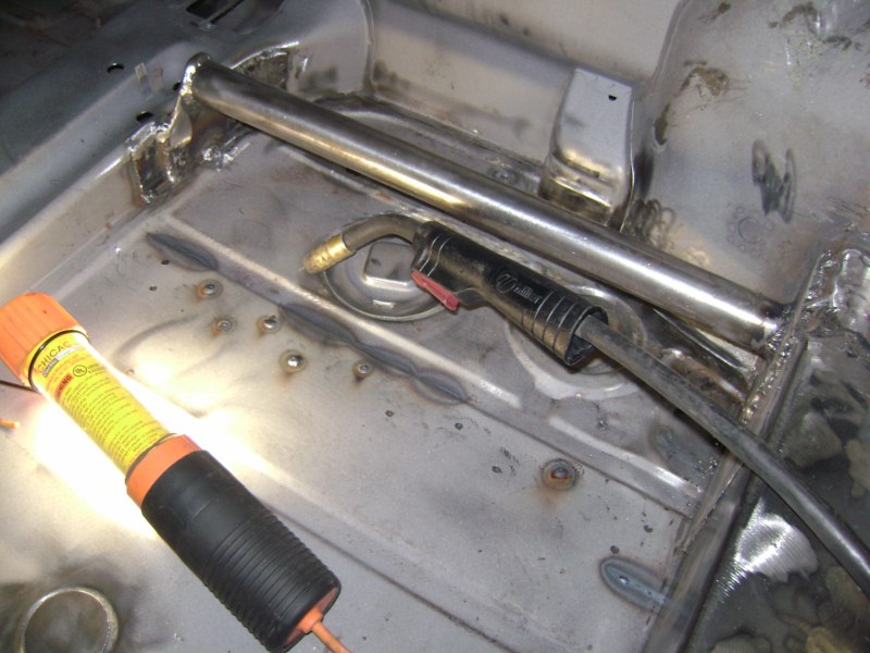

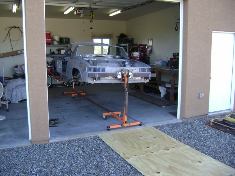

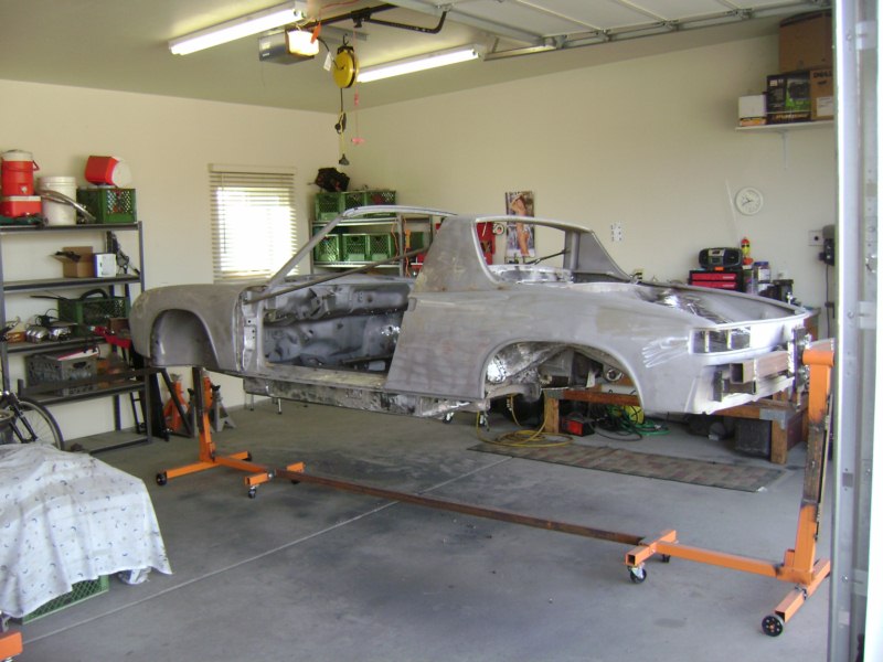

Cire   I decided to brace the sitting area. Here is my w...   Nov 18 2009, 08:30 PM

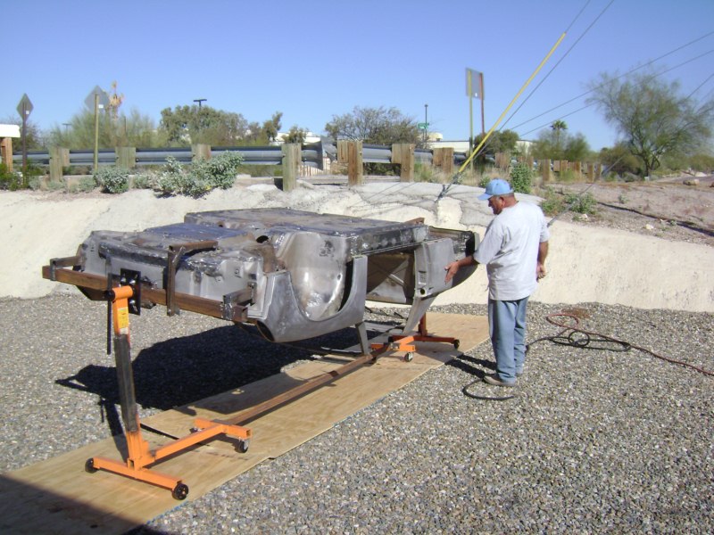

Cire   I also decided to build a Rottisserie. Eric ...   Nov 18 2009, 08:32 PM
Gint   That's a Delphi car! Going to paint it th...   Nov 19 2009, 09:04 AM
Cire   That's a Delphi car! Going to paint it t...   Nov 19 2009, 11:16 AM
Cire   RE: Start of a new Project Thread   Nov 20 2009, 05:24 AM
Cire   RE: Start of a new Project Thread   Nov 20 2009, 06:42 AM
strawman   Nice progress! I would suggest that you consid...   Nov 20 2009, 09:46 AM
Vacca Rabite   :agree: Widen the stance. You really don't ev...   Nov 20 2009, 11:32 AM
bigkensteele   :agree: Widen the stance. You really don't e...   Nov 20 2009, 12:39 PM
Vacca Rabite   I was at HF this morning looking at engine stand ...   Nov 21 2009, 11:43 AM

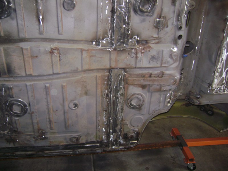

Cire   I got 90% of my welding done. Most of the holes a...   Nov 30 2009, 07:38 AM

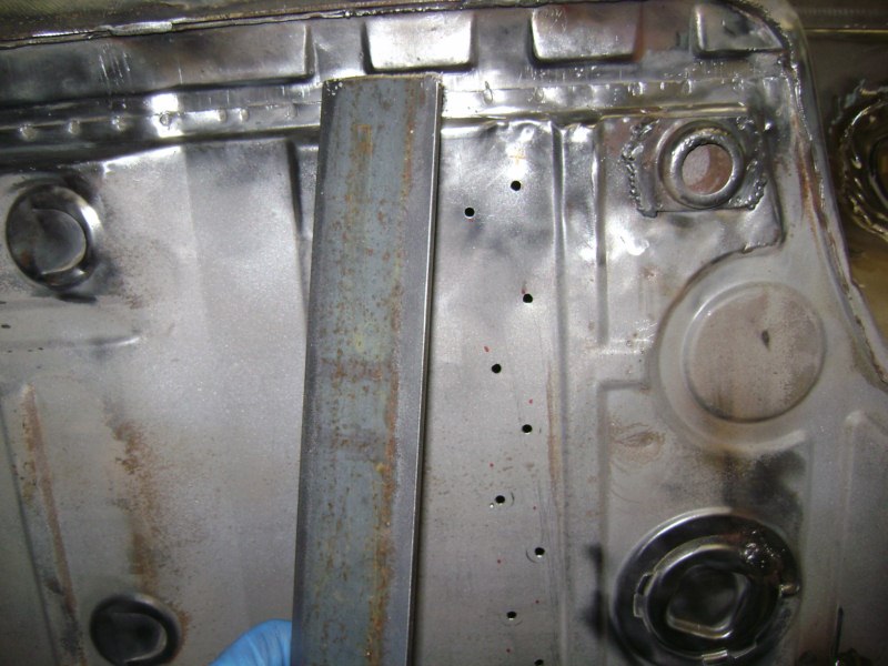

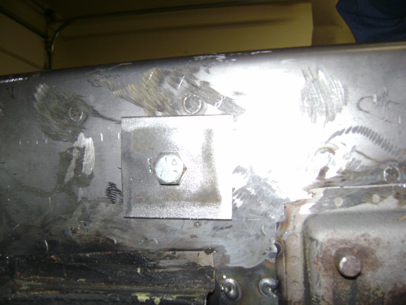

Cire   More pictures....   Jan 31 2010, 07:54 PM
Cire   RE: Start of a new Project Thread   Jan 31 2010, 07:56 PM

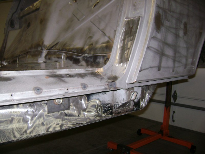

Cire   On the third picture... Where it shows the rear s...   Jan 31 2010, 08:05 PM

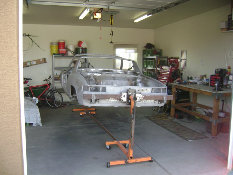

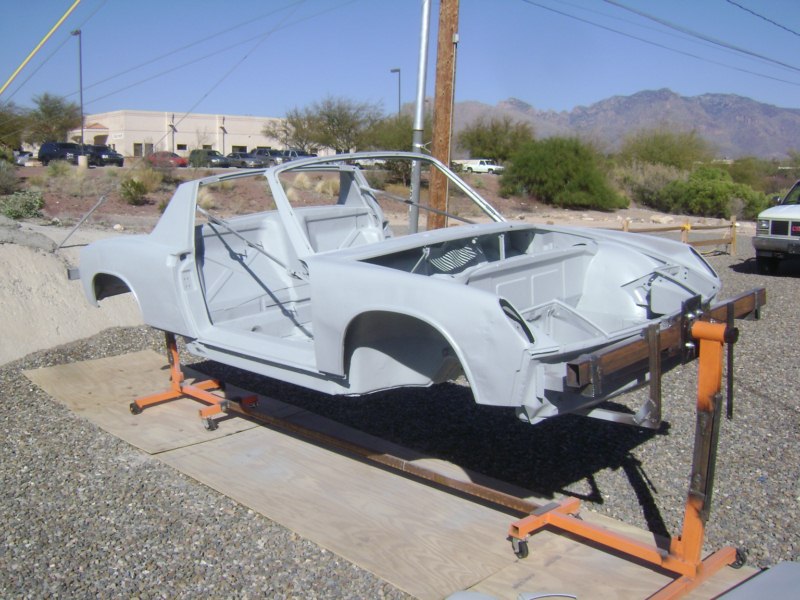

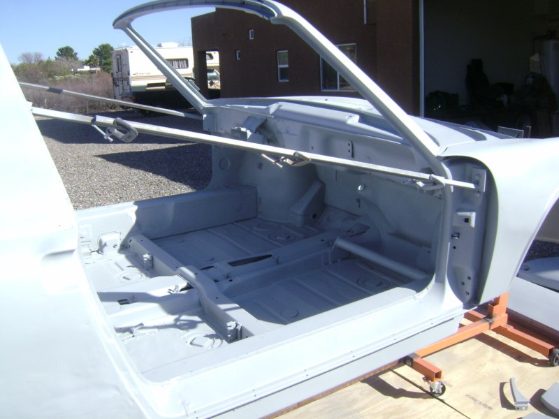

Cire   Where we started.... Where we are....   Jan 31 2010, 08:07 PM
bcaschera   Good work!! If i were to post a where it w...   Jan 31 2010, 11:40 PM

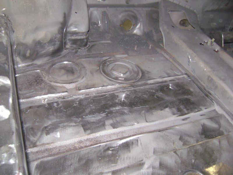

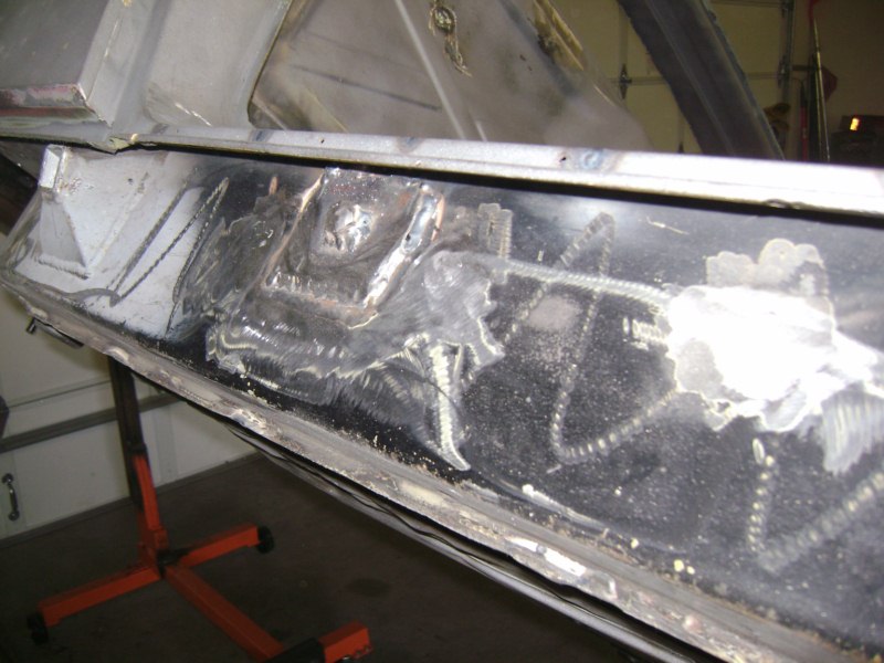

Cire   More Pictures. I got the Rob Mayeur Long Kit inst...   Feb 16 2010, 07:41 AM
Cire   RE: Start of a new Project Thread   Feb 16 2010, 07:43 AM
Cire   RE: Start of a new Project Thread   Feb 16 2010, 07:45 AM
Cire   RE: Start of a new Project Thread   Feb 16 2010, 07:46 AM
Cire   RE: Start of a new Project Thread   Feb 16 2010, 07:48 AM
Cire   RE: Start of a new Project Thread   Feb 16 2010, 07:49 AM
Cire   RE: Start of a new Project Thread   Feb 16 2010, 07:51 AM
Cire   RE: Start of a new Project Thread   Feb 16 2010, 07:53 AM
Cire   RE: Start of a new Project Thread   Feb 16 2010, 07:54 AM
Cire   RE: Start of a new Project Thread   Feb 16 2010, 07:56 AM
Cire   Argggg I got a 911 a arm verses a 914... Spent h...   Feb 16 2010, 07:58 AM

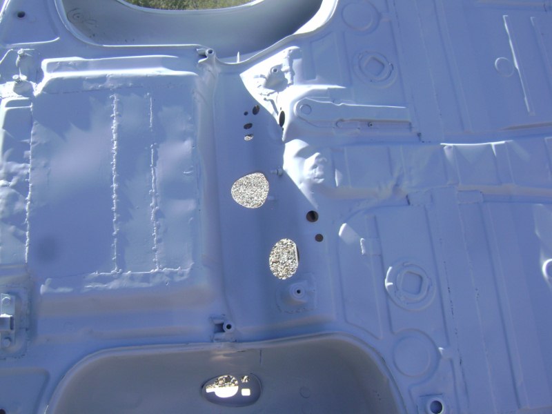

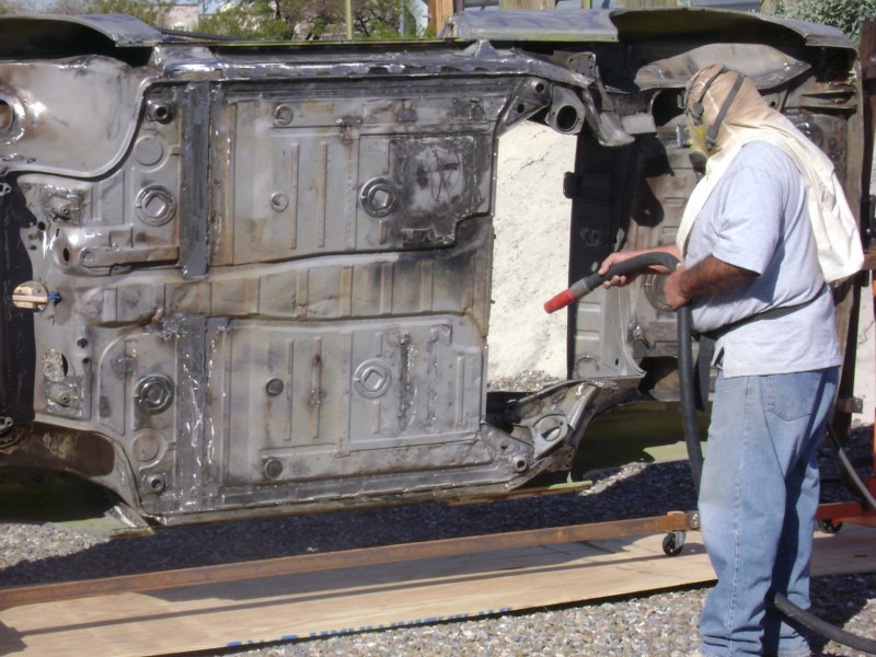

Cire   Tomorrow the guy comes to Soda Blast it one more t...   Feb 16 2010, 09:33 AM

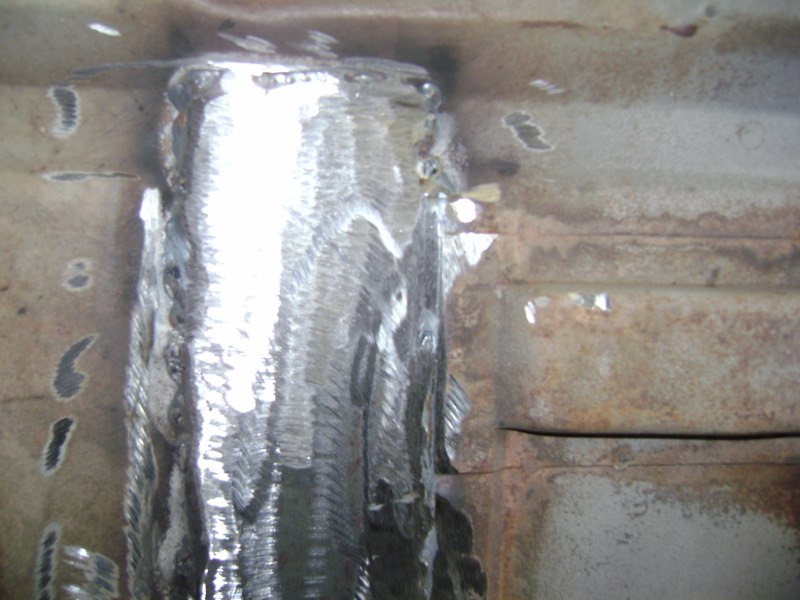

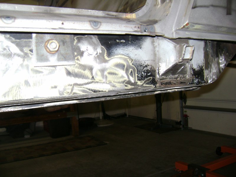

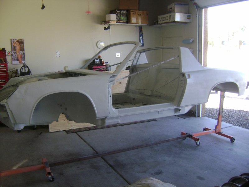

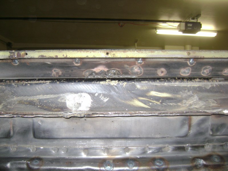

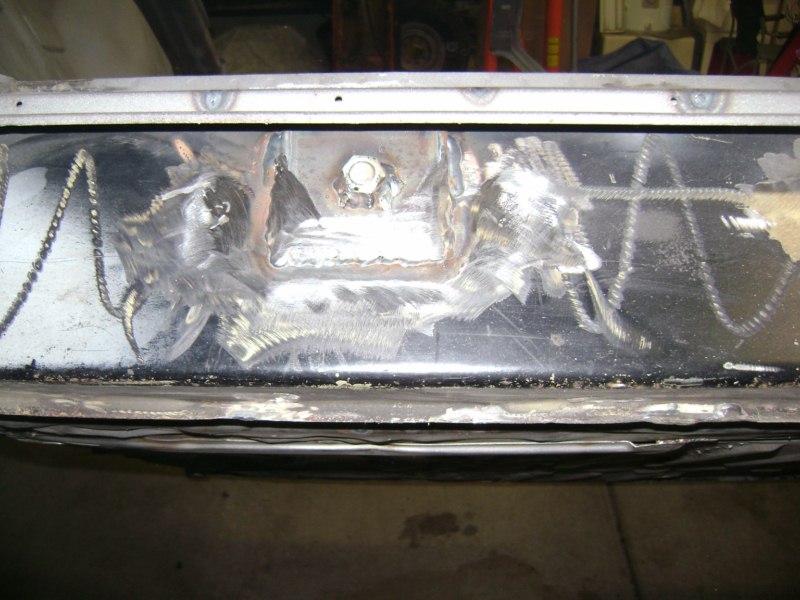

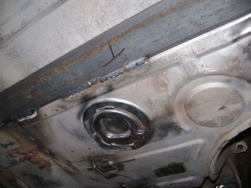

Cire   So the car has the Engman stiffening internal kit....   Feb 17 2010, 06:55 PM
Cire   RE: Start of a new Project Thread   Feb 17 2010, 06:57 PM
Cire   RE: Start of a new Project Thread   Feb 17 2010, 06:59 PM
Cire   RE: Start of a new Project Thread   Feb 17 2010, 07:01 PM
Cire   RE: Start of a new Project Thread   Feb 17 2010, 07:02 PM
Cire   RE: Start of a new Project Thread   Feb 17 2010, 07:04 PM
Cire   RE: Start of a new Project Thread   Feb 17 2010, 07:06 PM
Cire   RE: Start of a new Project Thread   Feb 17 2010, 07:07 PM

MDG   The pics in Post 76 . . . that's a long way in...   Feb 19 2010, 12:11 PM
Cire   The pics in Post 76 . . . that's a long way i...   Feb 23 2010, 07:24 PM

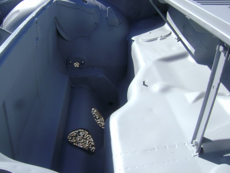

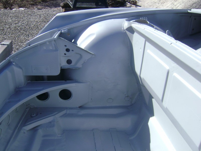

Cire   4 hours of blowing sand out of every hole I could ...   Feb 23 2010, 07:35 PM

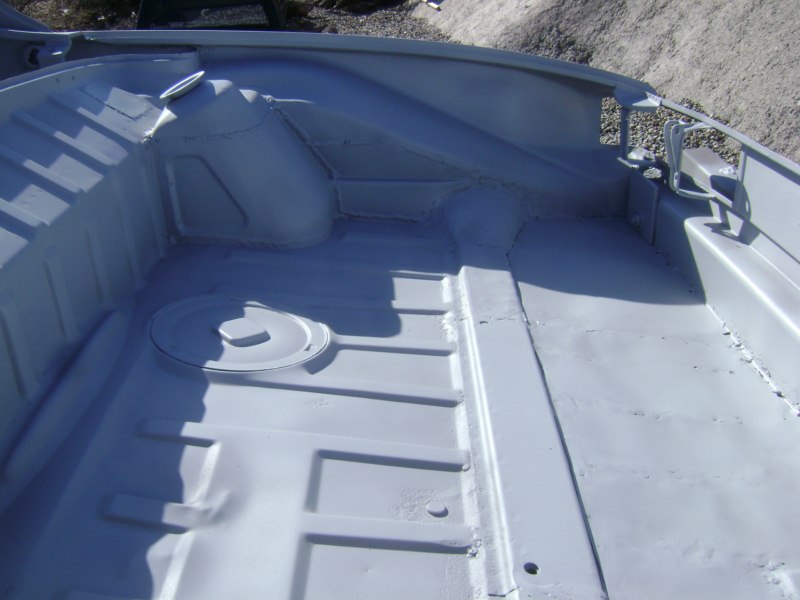

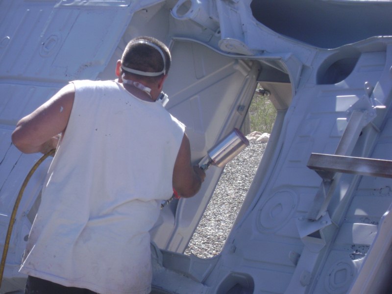

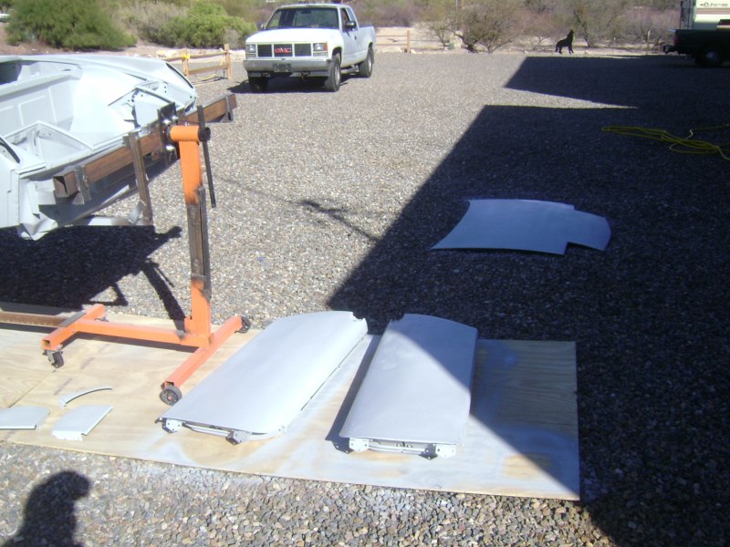

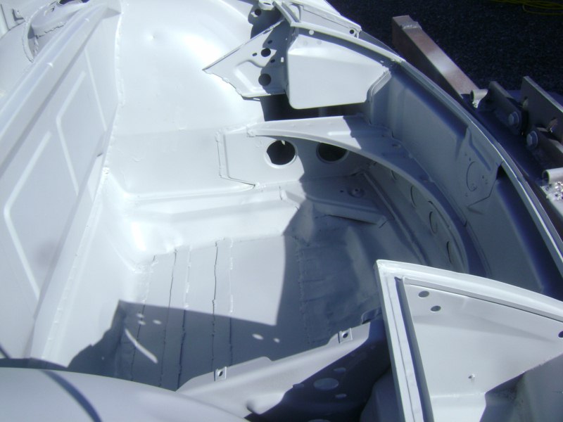

Cire   Now for the prime-ing.... = )   Feb 23 2010, 07:36 PM
Cire   RE: Start of a new Project Thread   Feb 23 2010, 07:38 PM
Cire   RE: Start of a new Project Thread   Feb 23 2010, 07:39 PM
Cire   RE: Start of a new Project Thread   Feb 23 2010, 07:41 PM
Cire   RE: Start of a new Project Thread   Feb 23 2010, 07:43 PM
Cire   Tomorrow we shoot the yellow color. = ) Whew... ...   Feb 23 2010, 07:44 PM
