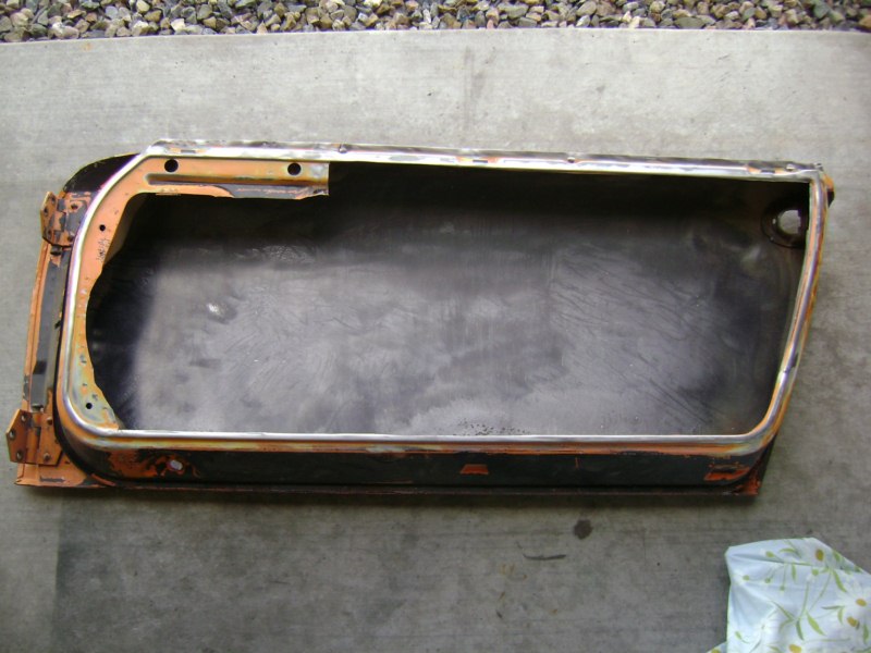

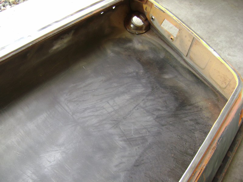

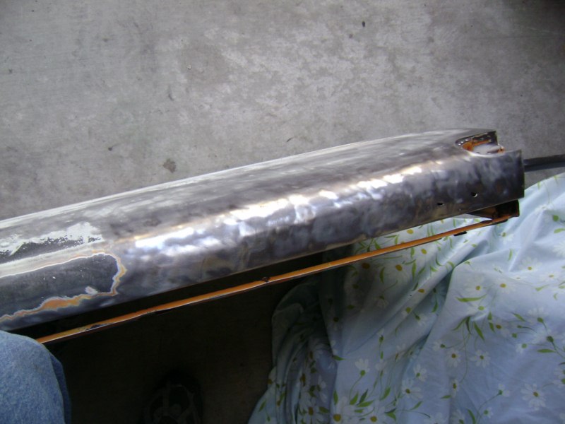

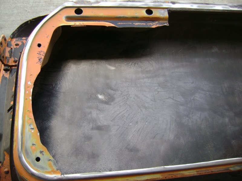

Door Time. I decided to cut up a door and see about skinning it. Cut it is SOOO much lighter than the regular door. Crazy difference.
ERic

QUOTE(Cire @ Feb 19 2010, 10:59 AM) *
ERic
Anyone ever done doors before? How much can I take out? Is it better to use Aluminum to skin it or thin gauge steel? Is there anything that needs to be done before you put on the aluminum? I havent done a door before and would love some insuights.
Thanks all.
Eric
