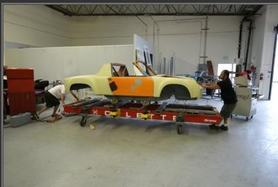

I just did a Google search for "celette bench shop" and one of the first hits was this one.
celette bench
From that web site:
Looks like the best posible place to start! Even has 914 content and I didn't even include that in the search criteria!
P.S. i am just up the road from you in Madison (for now). If you ever need a hand (I'm not that useful) with a project taht requires more than 2 hands, give me a PM throught the site!
rick 918-S
post Feb 20 2010, 08:23 PM
Hey nice rack! -Celette
Posts: 21,340
From: Now in Superior WI
Member No.: 43
QUOTE(gopack @ Feb 20 2010, 11:52 AM) *
celette bench
From that web site:
That link is awsome! Read the post on the page. A Cellette rep posted is number and states he is in Lombard IL. About 75 miles from Rockford. Call him. He will know where the Cellette shops are.

turnaround89   What makes the celette better than othe racks? Al...   Feb 21 2010, 10:24 PM
rick 918-S   What makes the celette better than othe racks? A...   Feb 21 2010, 10:46 PM
SirAndy   Lots more pix ... http://www.914world.com/bbs2/in...   Feb 21 2010, 11:15 PM
Jeff Hail   The shop in the photos is Ed Palmer's. Aka EPR...   Feb 21 2010, 11:30 PM
turnaround89   Sir andy - if you don't mind me asking, how mu...   Feb 21 2010, 11:32 PM
SirAndy   Sir andy - if you don't mind me asking, how m...   Feb 21 2010, 11:51 PM
turnaround89   does the place doing the chassis alignment rent th...   Feb 22 2010, 12:18 AM
SirAndy   does the place doing the chassis alignment rent t...   Feb 22 2010, 12:26 AM
rick 918-S   does the place doing the chassis alignment rent t...   Feb 22 2010, 12:56 AM
rick 918-S   does the place doing the chassis alignment rent ...   Feb 22 2010, 01:08 PM
SirAndy   Your inquiry just prompted me to do something I h...   Feb 22 2010, 01:16 PM
