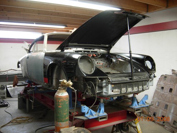

SirAndy   Lots more pix ... http://www.914world.com/bbs2/in...   Feb 21 2010, 11:15 PM
Jeff Hail   The shop in the photos is Ed Palmer's. Aka EPR...   Feb 21 2010, 11:30 PM
turnaround89   Sir andy - if you don't mind me asking, how mu...   Feb 21 2010, 11:32 PM
SirAndy   Sir andy - if you don't mind me asking, how m...   Feb 21 2010, 11:51 PM

SirAndy   Your inquiry just prompted me to do something I h...   Feb 22 2010, 01:16 PM
