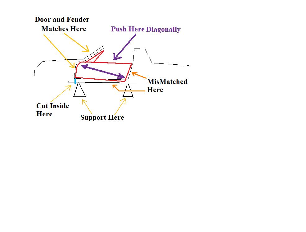

Let me try to break this down for you if I can. Porsche doors don't get shims. If the door required shims on the lower hinge the car is bent.
Here's a crude drawing of what you should try based on your discription.
Get a hand pump port-o-power and carefully set it up in the car. The lower should be on top of the long in the corner against the rear bulkhead. The other end should be against a wood block about the height of the upper hinge. Take a mm tape measure and check your progress.

turnaround89   that is exactly what my passenger side door looks ...   Feb 26 2010, 10:41 PM
rick 918-S   Here's another crude sketch. I assume you used...   Feb 26 2010, 11:21 PM
turnaround89   what your saying is fixing the door, should also f...   Feb 26 2010, 11:49 PM
rick 918-S   what your saying is fixing the door, should also ...   Feb 27 2010, 08:02 AM

turnaround89   i did exactly what rick told me to do, i used a bo...   Mar 4 2010, 06:21 PM
rick 918-S   i did exactly what rick told me to do, i used a b...   Mar 4 2010, 06:36 PM
