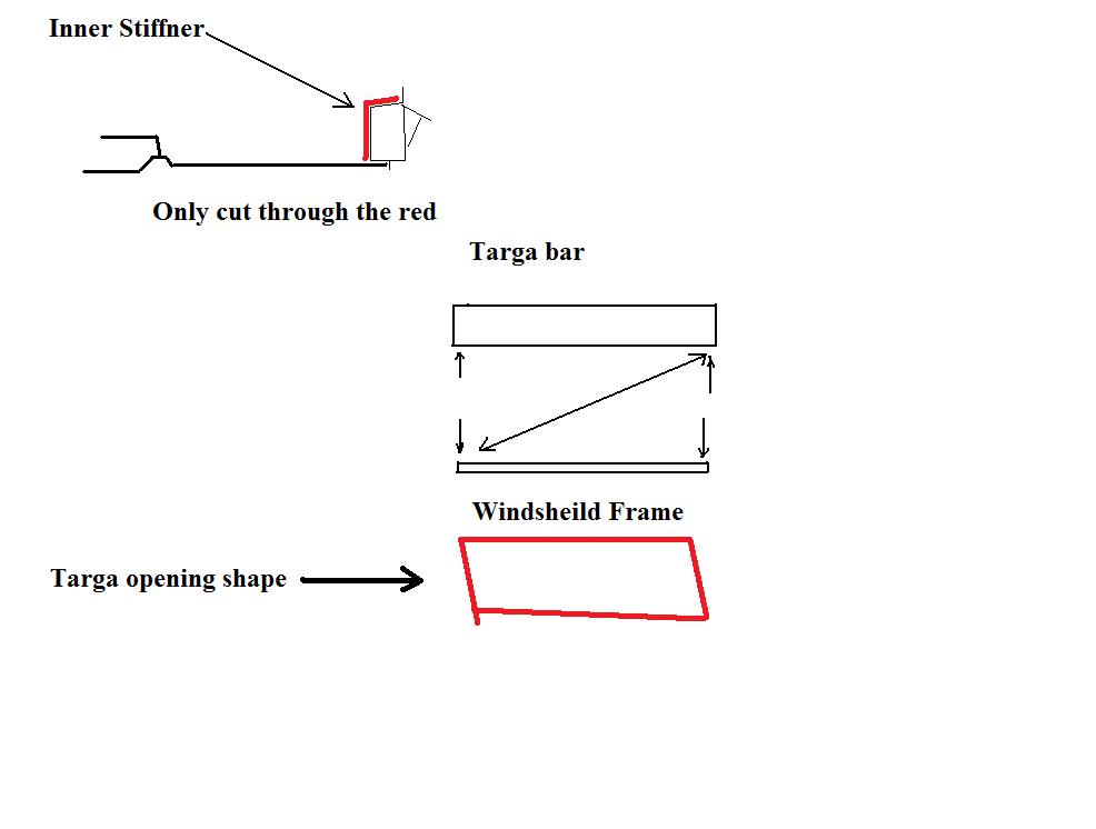

Here's another crude sketch. I assume you used something like the Engman kit for a chassis stiffening kit. If you did just cut vertically through the kit as shown in red.
Also you seem to be saying the windsheild is off center from the targa bar.
The measurements should show the right side from the targa bar to the WS frame should be shorter than the left side. Also the diagonal should show the measurement from the right WS corner to the left targa bar should be shorter than the left SW to right targa.
So. As you push the cowl forward and even out the targa top opening the diagonal should straighten.
