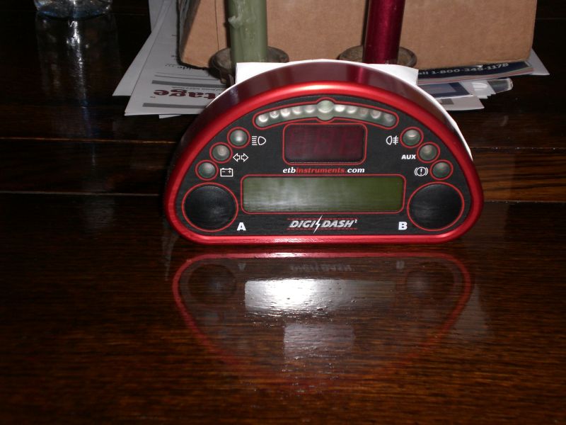

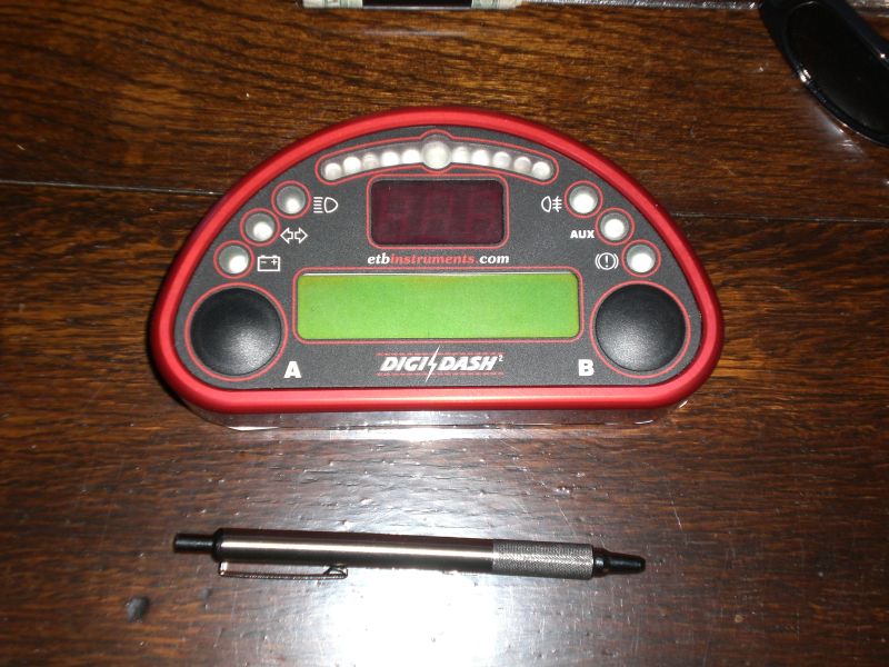

d914   went parts hunting in NASCAR country and came up w...   Dec 10 2009, 02:03 PM
BIGKAT_83   Let see some pictures of the ROCK battery. Thats a...   Dec 10 2009, 07:24 PM
