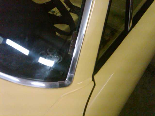

Still making small progress, I got almost all the wiring cleaned up, all lights work horn works eliminated the mess the po made under the pass seat, ran the wires for the oil pressure and oil temp.. then we have been polishing all the trim on the car,.. it is coming out great I had done the triangle windows before, we got the windshield trim done and got it put on , what a difference....

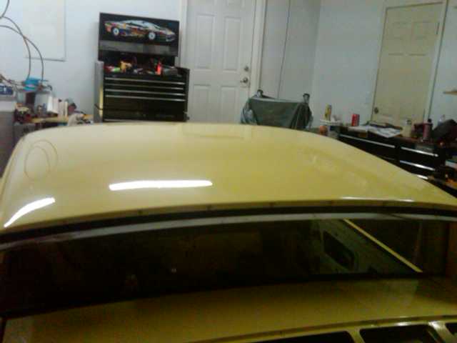

The rear targa trim polished also

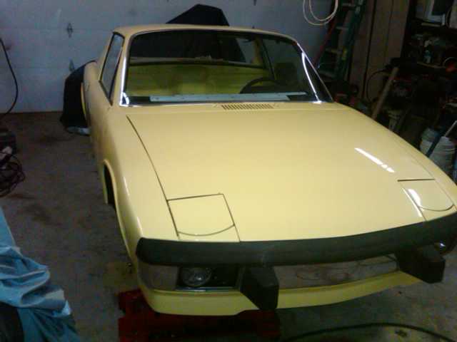

wayne1234   Alot more progress, I finally finished the paint, ...   Jan 2 2010, 12:10 AM

wayne1234   I'm really happy with how the paint is coming ...   Jan 3 2010, 03:08 PM
