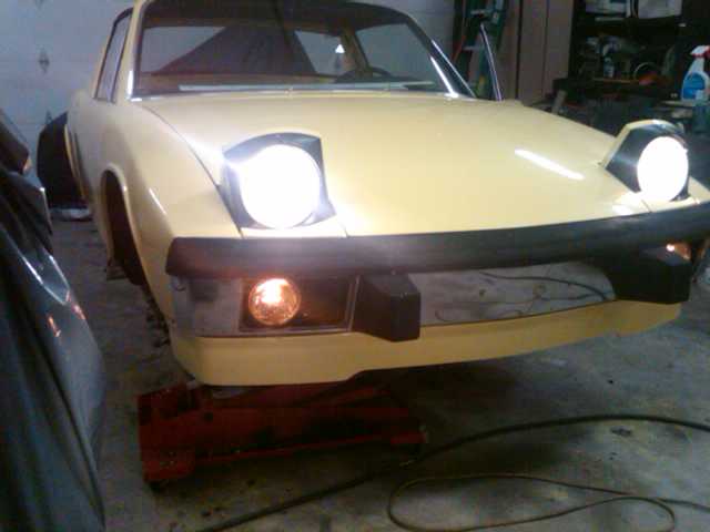

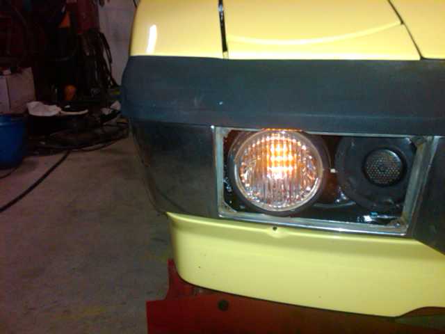

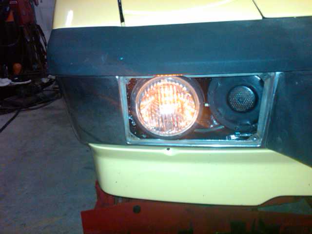

Then the new mod... I realised I have no front parking lights and turn signals up front because of the slope nose. So I took the fog lights apart and added 2 sets of led lights, a small set in the middle for parking lights, then a flexible strip around the ring of the light for the turn signals.. they are bright and because of the reflective piece in the light they can be seen off angle as well. I'm pumped they came out so well. and now I'm legal. What do you guys think? I got the the headlights totally finished also and the rear glass mounted (IMG:style_emoticons/default/biggrin.gif)
