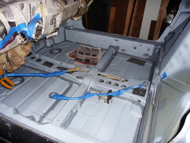

It has been a while since an update but, progress is happening slowly. (IMG:style_emoticons/default/yellowsleep[1].gif)
My 9 month old daughter has been the focus of my non-working hours at the Firehouse but, I have been able to sneak into the garage once and a while (IMG:style_emoticons/default/welder.gif)
I installed the Engman Stiffening kit.
(Now for the OCD part) I stripped out all of the Por-15 in the passenger compartment and engine bay and prepped it again for Acid Etching Primer.
Passenger interior firewall is a mix of two different colors (leftovers of the same brand) Then, a round of seam sealer.
The engine bay will receive the same treatment after all the welding is completed.
2K Primer will be the next layer before paint.
I went against Por-15 because of many mixed results and the better application of the primers.

Zaney   Pic of interior firewall Engine bay firewall   Mar 7 2010, 12:48 AM
Zaney   Hell hole ready for seam sealer and 2K Primer. 16...   Mar 7 2010, 12:50 AM
Zaney   And the trunk firewall before being boxed out for ...   Mar 7 2010, 12:58 AM
