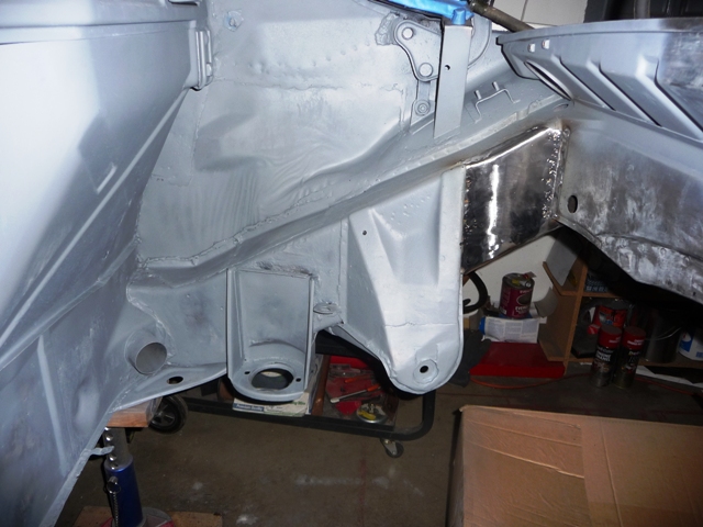

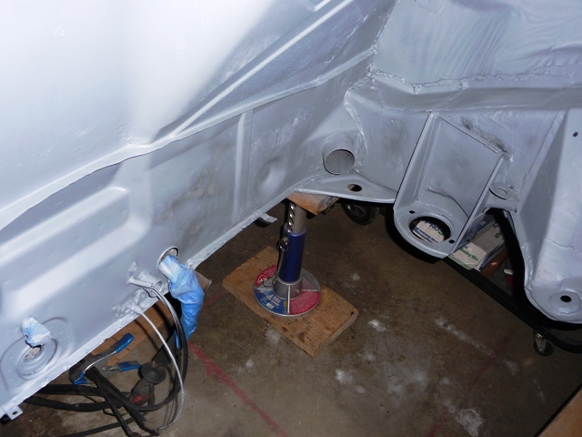

Hell hole ready for seam sealer and 2K Primer.
16 gauge gusset plate welded into place ready for the Suby motor mount bar placement. (IMG:style_emoticons/default/welder.gif)
Lower shot

Zaney   Hell hole ready for seam sealer and 2K Primer. 16...   Mar 7 2010, 12:50 AM
