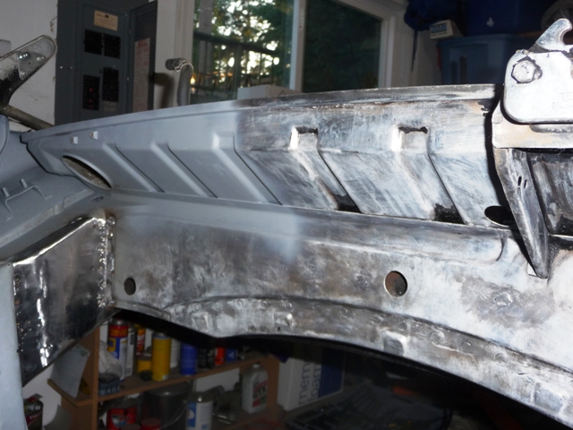

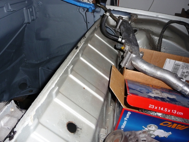

Zaney   It has been a while since an update but, progress ...   Mar 7 2010, 12:46 AM
Zaney   Pic of interior firewall Engine bay firewall   Mar 7 2010, 12:48 AM
Zaney   Hell hole ready for seam sealer and 2K Primer. 16...   Mar 7 2010, 12:50 AM
Zaney   And the trunk firewall before being boxed out for ...   Mar 7 2010, 12:58 AM
