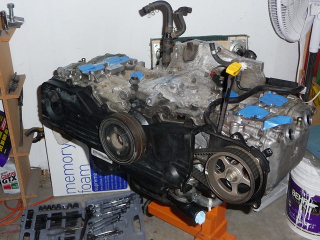

This is what I am battling right now.
I can't seem to remove the stubborn crankshaft pulley 22mm bolt. A little overnight Aerocoil and maybe an impact wrench will get it off. I plan on replacing the stock pulley with a lightened one.
Any other suggestions are more than welcome to remove the frozen bolt.! (IMG:style_emoticons/default/smash.gif)

strawman   I can't seem to remove the stubborn cranksha...   Mar 8 2010, 10:17 AM
Zaney   Geoff, I believe that you are correct! ...   Mar 8 2010, 07:19 PM
Zaney   So after celebrating my daughter's 1st Birthda...   May 24 2010, 11:33 PM
Zaney   Drove down to Tacoma where I stopped by Delta Cams...   May 24 2010, 11:37 PM
Zaney   Exhaust side Longblock assembled after reading ...   May 24 2010, 11:40 PM
