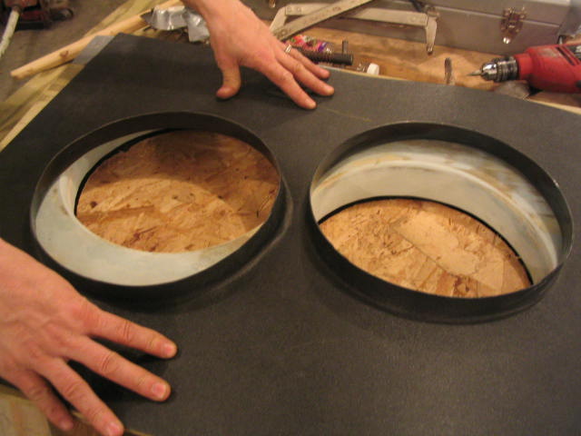

rick 918-S   Made a vacum form for the fan shroud.   Feb 29 2004, 11:34 PM
rick 918-S   after trimming   Feb 29 2004, 11:35 PM
rick 918-S   Starting to heat the ABS in the form. We used a sh...   Feb 29 2004, 11:47 PM
krk   Rich, Thx for posting these pics! It's co...   Mar 1 2004, 12:22 AM
Gint   That's pretty impressive Rich. More pics!   Mar 1 2004, 12:43 AM
