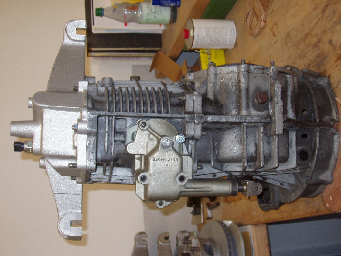

am nearly finnished now with all parts. Received further parts from the turning workshop (ballhead-lever, shiftrod). Only thing left still is the intermediate plate of the shift housing. We started making clamping fixture yesterday and I can probably start milling on Monday.
Mounted an old magnesium case 915 gearbox with my parts. Used the original 916 shift housing as my intermediate plates are still not finnished. Only made one adjustment of the shiftrods inside and the gearbox shifted really brilliant.
Will make some more pictures of the mounted unit and show you (didn´t have my digicam with me when I was in the workshop yesterday).
We made a further and even better batch of these bearing supports that have to be mounted into the gearbox. They are milled out of a block of billet aluminium. Pictures to follow also.
By mid of next week all parts will be done. Only issue then is the mechanical speedo drive. Will be important for those that will use the old magnesium case 915 gearbox. That will be the very final part.
Will keep you informed and post further pictures.

bugat5speed   Hi together, we made the first two conversions wi...   Apr 26 2010, 01:42 AM
Racer Chris   Hi together, we made the first two conversions w...   Apr 26 2010, 11:00 AM
bugat5speed   Sorry Chris, if we had talked about it it would n...   Apr 26 2010, 12:55 PM
Racer Chris   I sent one email before beginning the alterations ...   Apr 26 2010, 07:03 PM
bugat5speed   Hi Chris and all of you, here are first picture...   Apr 28 2010, 12:59 PM
bugat5speed   another picture:   Apr 28 2010, 01:02 PM
bugat5speed   more pictures instead of explanations (sometimes n...   May 3 2010, 12:35 PM
bugat5speed   and another one:   May 3 2010, 12:36 PM
turboman808   HAHA That would have made it easier. Everything ...   May 3 2010, 12:38 PM
bugat5speed   Hi turboman808, nice to hear that it´s working f...   May 4 2010, 01:04 AM
