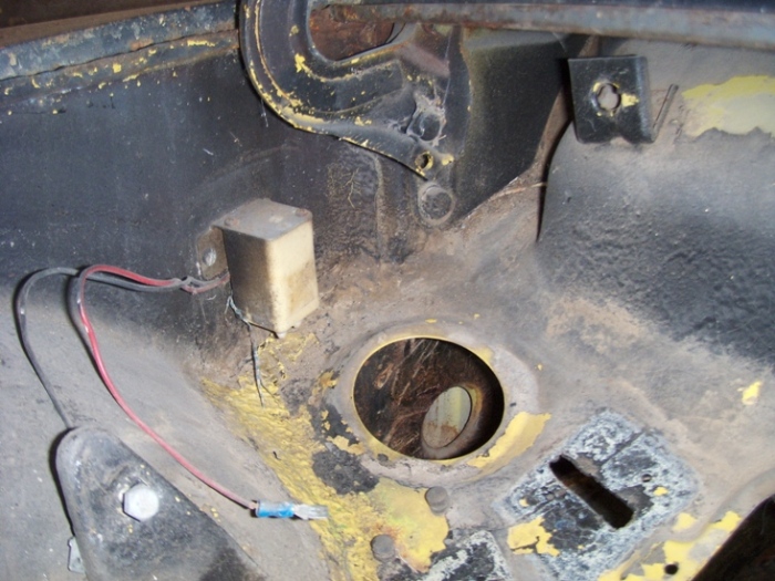

Eric_Shea   Is that where the factory mounted the washer pump?   Mar 27 2010, 06:22 PM
Socalandy   :shock1:   Mar 27 2010, 06:24 PM
Socalandy   You guys tell me but Im thinking so Is that whe...   Mar 27 2010, 06:25 PM
SirAndy   You guys tell me but Im thinking so Is that wh...   Mar 27 2010, 11:44 PM
Socalandy   :)   Mar 27 2010, 06:26 PM
Eric_Shea   I don't recall from my six. I'll let othe...   Mar 27 2010, 06:28 PM
