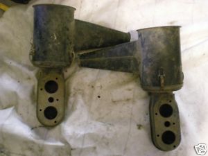

Issue with these 912 air cleaners is the bolt-on pattern is different of course. I knew that when I bought them, and know I could modify them to work and look as though they were put on at the factory. But it'll be work.
I've been looking and cannot find anything that is made for webers that helps to reduce the intake noise. Do rain hats help? The outer foam covers? Was there ever a euro or ROW dual carb application air cleaner set-up from a Type2 or Type3 I could use? Any advice would be most helpful. (IMG:style_emoticons/default/idea.gif) Attached image(s)

Andyrew What are the 912 air cleaners made out of? Could y... Apr 20 2010, 11:15 AM
Root_Werks
What are the 912 air cleaners made out of? Could ... Apr 20 2010, 01:48 PM
Phoenix 914-6GT :headbanger: Apr 20 2010, 11:16 AM
Andyrew Another Idea I just had was to cut off the caniste... Apr 20 2010, 02:00 PM
Root_Werks
Another Idea I just had was to cut off the canist... Apr 20 2010, 02:31 PM
