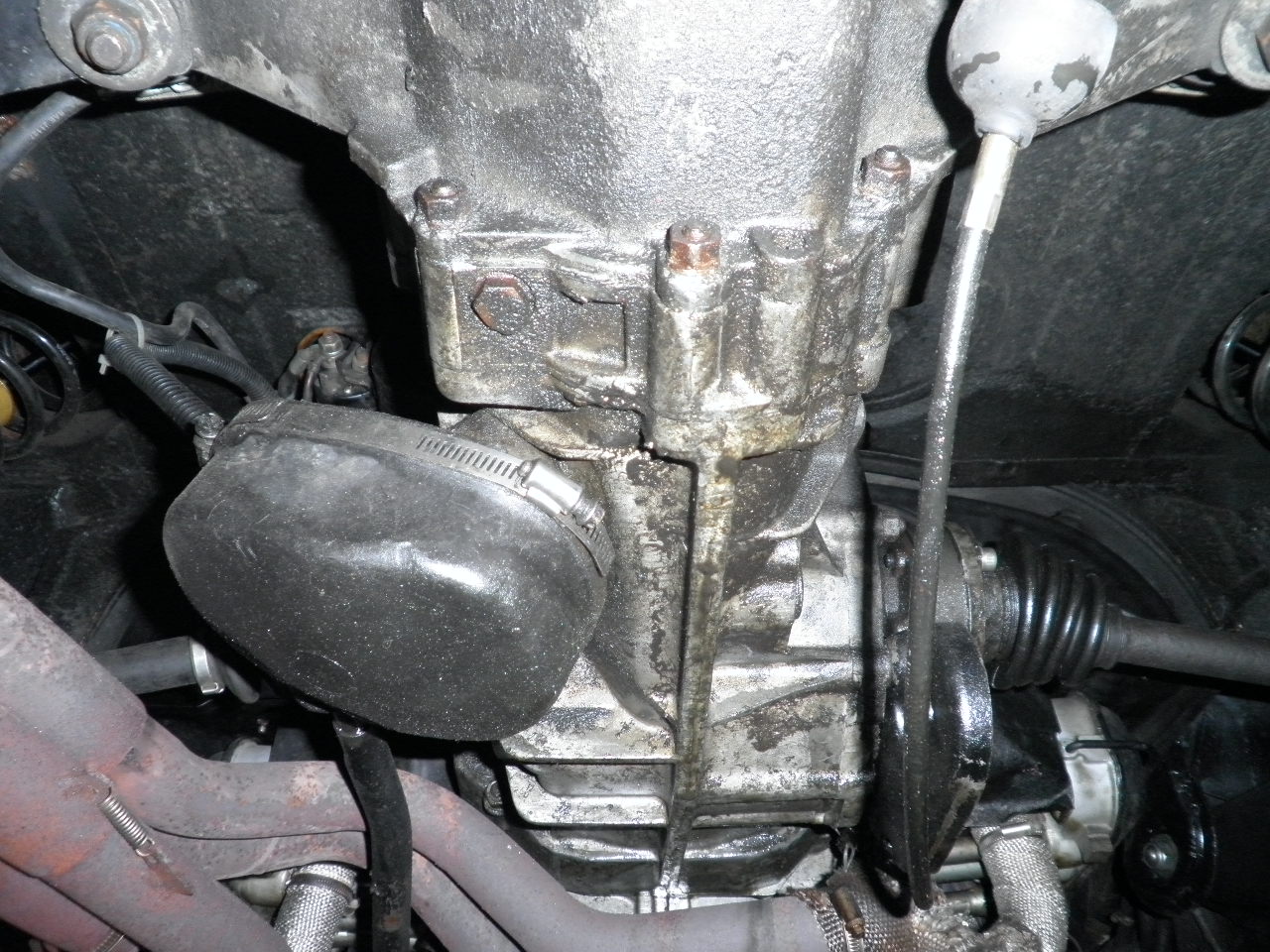

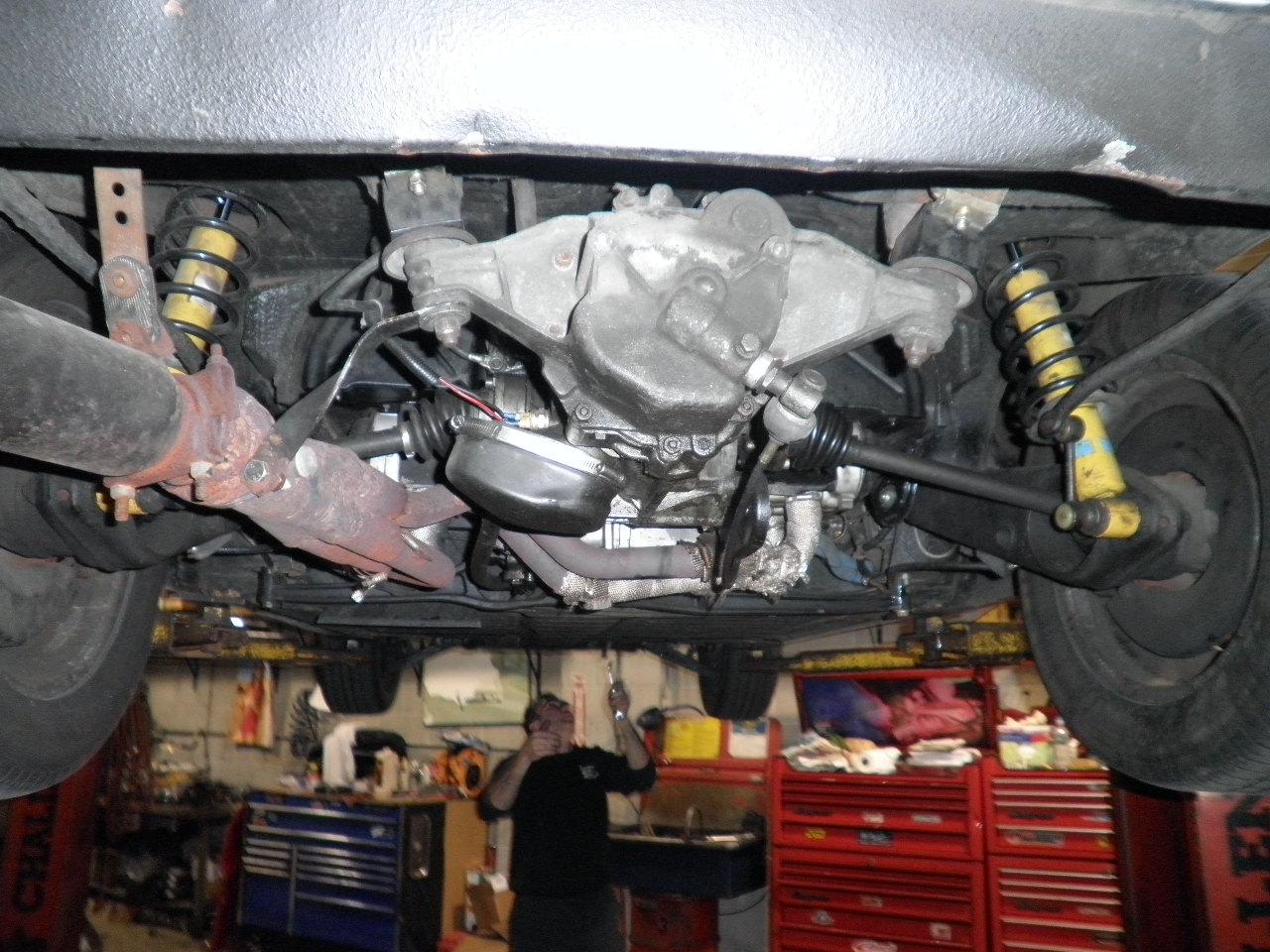

I'm considering buying this car. It leaks a few drops of oil when it sits overnight, the heat has been removed but he has all the parts -- i'll put it back on.
Scroll down for all pics.
Please opine... (IMG:style_emoticons/default/popcorn[1].gif)

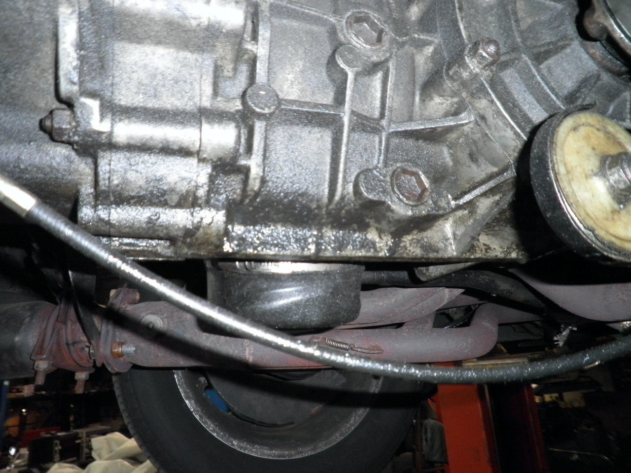

scotty b   Well you've got the mechanical parts coverd in...   Apr 12 2010, 05:41 PM

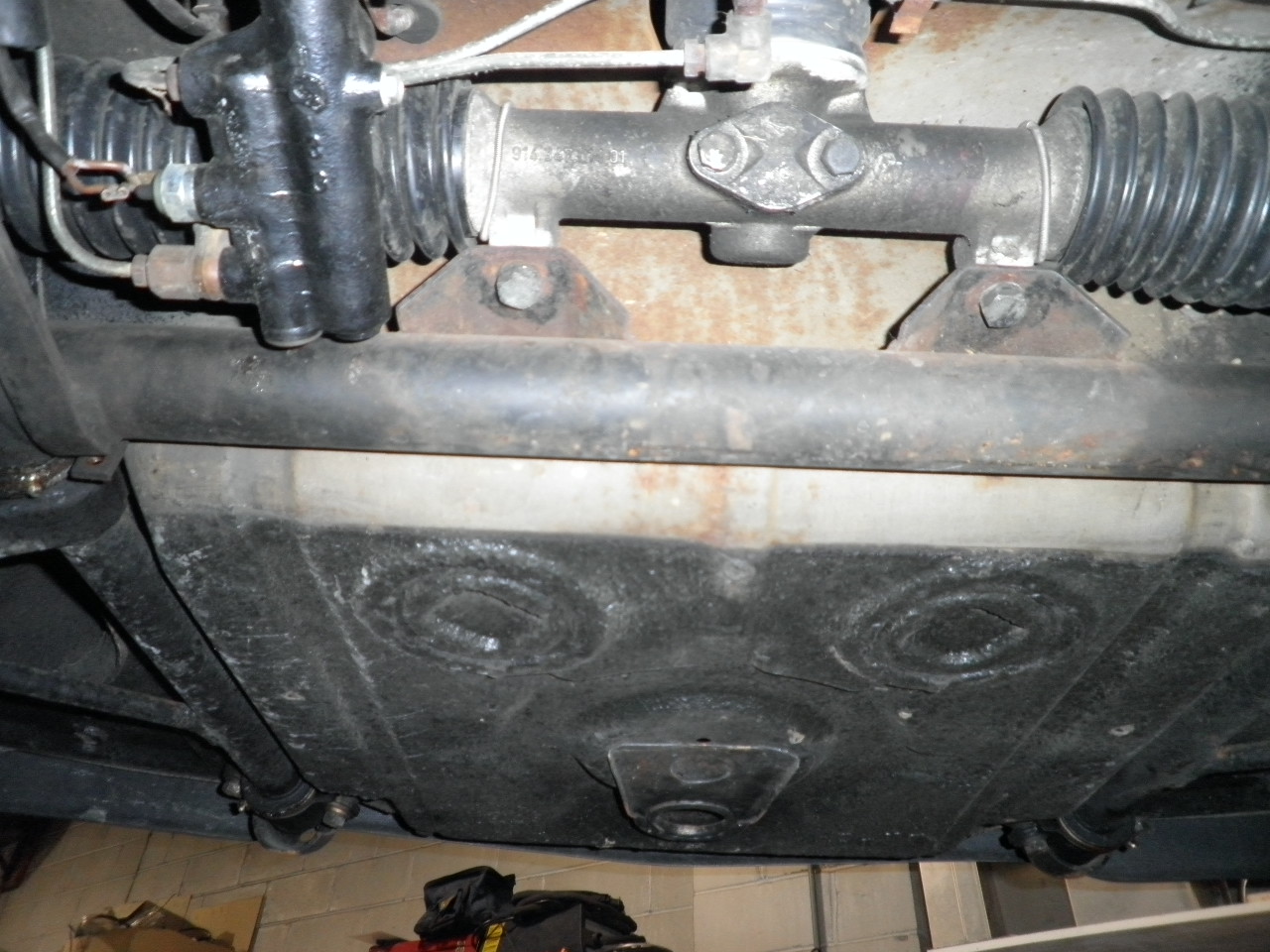

Tom_T   Rob, That looks like a possible rust problem up b...   Apr 12 2010, 05:47 PM
rwilner   Rich, That looks like a possible rust problem up...   Apr 12 2010, 05:50 PM
rwilner   RE: Is this a good looking undercarriage?   Apr 12 2010, 05:56 PM

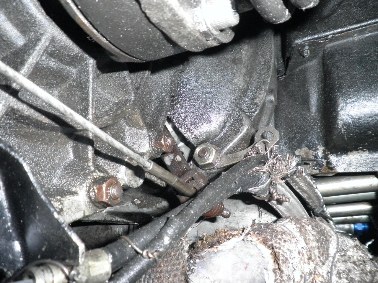

jasons   I see red flags. The clutch cable is "bailin...   Apr 12 2010, 05:51 PM
rwilner   I see red flags. The clutch cable is "baili...   Apr 12 2010, 05:58 PM

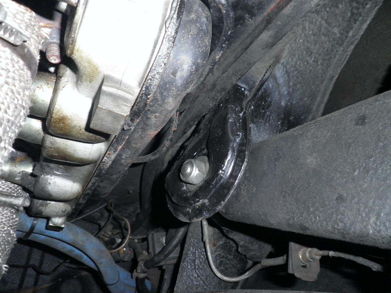

jasons   Yes -- suspension ears (both) were welded by Race...   Apr 12 2010, 06:01 PM
SirAndy   As for the clutch cable, I'm not familiar wit...   Apr 12 2010, 06:02 PM
SirAndy   The hell hole is rusted, your fuel pump mount has ...   Apr 12 2010, 05:54 PM
rwilner   The hell hole is rusted, I can't tell that ...   Apr 12 2010, 06:10 PM

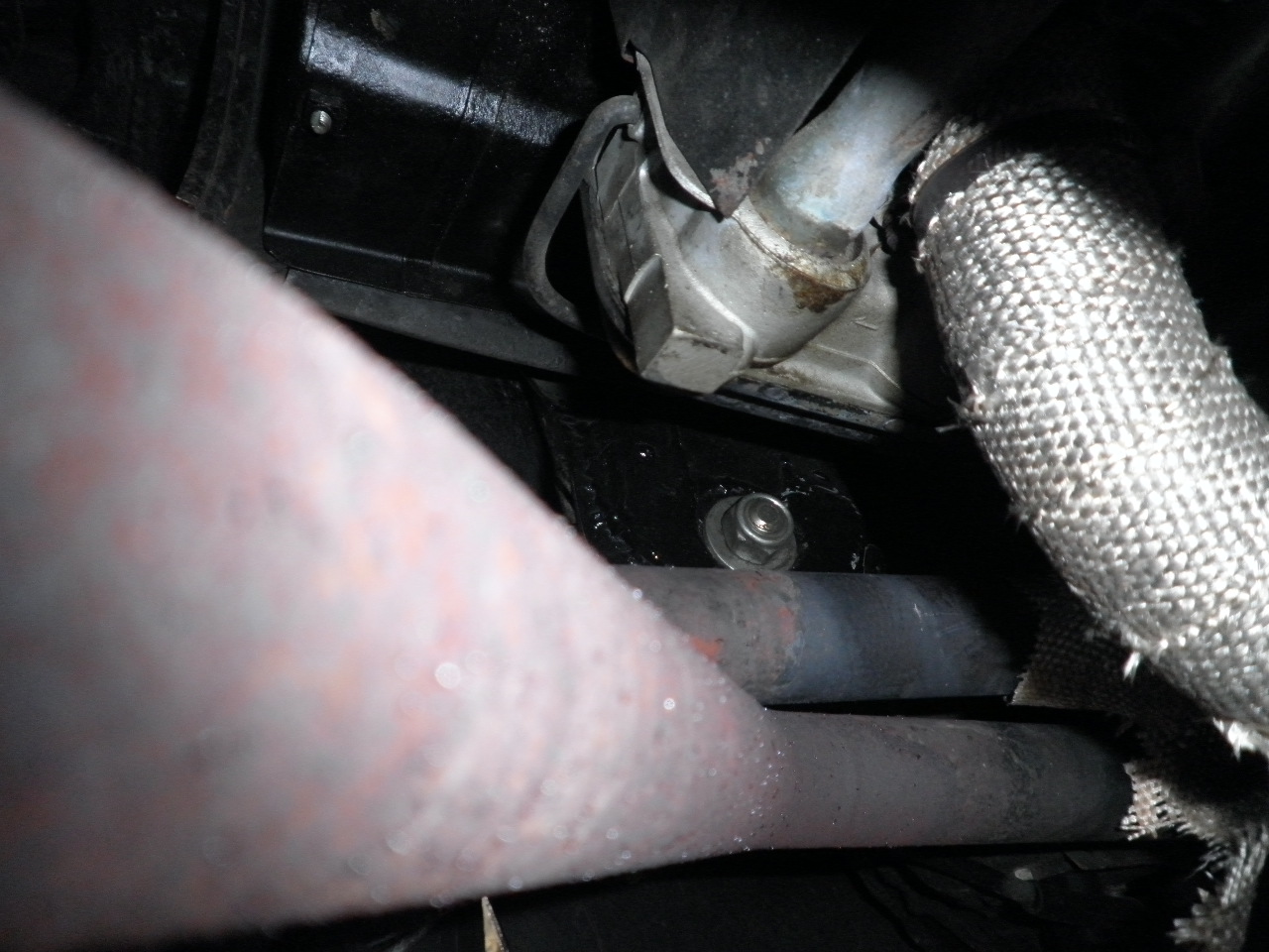

dlee6204   The car is going to need some work to make it righ...   Apr 12 2010, 05:57 PM
rwilner   How do you expect to add heat with headers and t...   Apr 12 2010, 06:00 PM

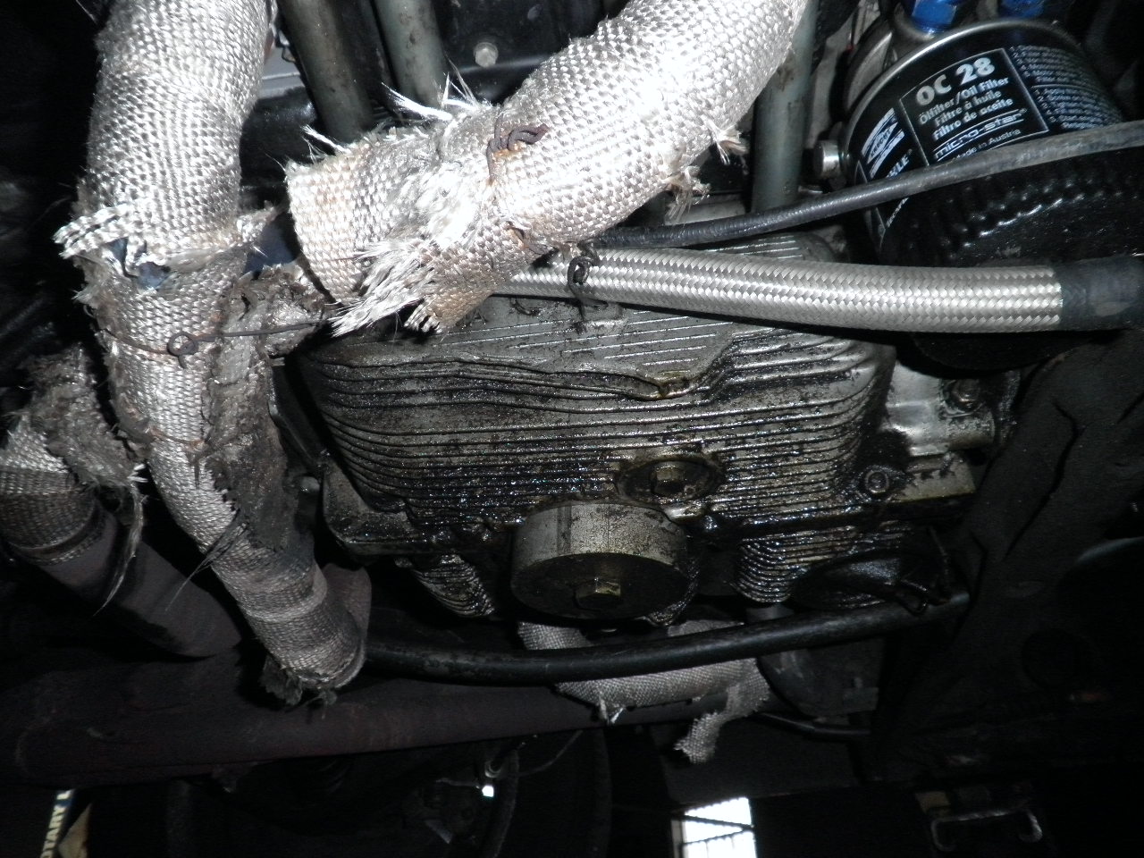

rwilner   This looks like leaking brake fluid but seller say...   Apr 12 2010, 06:01 PM
rwilner   Fancy Bushings!!   Apr 12 2010, 06:03 PM
6freak   This looks like leaking brake fluid but seller sa...   Apr 13 2010, 08:10 AM
McMark   The number of 'oddities' would make me ner...   Apr 12 2010, 06:13 PM
rwilner   if price is right, it doesn't look horrible. ...   Apr 12 2010, 06:20 PM
McMark   The right price depends on too many things. I...   Apr 12 2010, 06:28 PM
bandjoey   Take the inspection covers off of the tunnel by th...   Apr 12 2010, 08:46 PM
jaxdream   Check with the owner to see if he / she will allow...   Apr 13 2010, 08:02 AM
rwilner   Check with the owner to see if he / she will allo...   Apr 13 2010, 08:18 AM
rwilner   a few more pics   Apr 13 2010, 08:20 AM
Racer Chris   Pictures of the floor inside the car don't tel...   Apr 13 2010, 08:35 AM
jaxdream   I agree with Chris about the floor and tar boards ...   Apr 13 2010, 09:02 AM
dangrouche   For $5k, too much. It is clean. It looks to...   Apr 13 2010, 09:48 AM
rwilner   For $5k, too much. It is clean. It looks t...   Apr 13 2010, 10:29 AM
SirAndy   Dan, I am curious -- why do you say tranny synchr...   Apr 13 2010, 11:50 AM
rwilner   Dan, I am curious -- why do you say tranny synch...   Apr 13 2010, 12:33 PM
