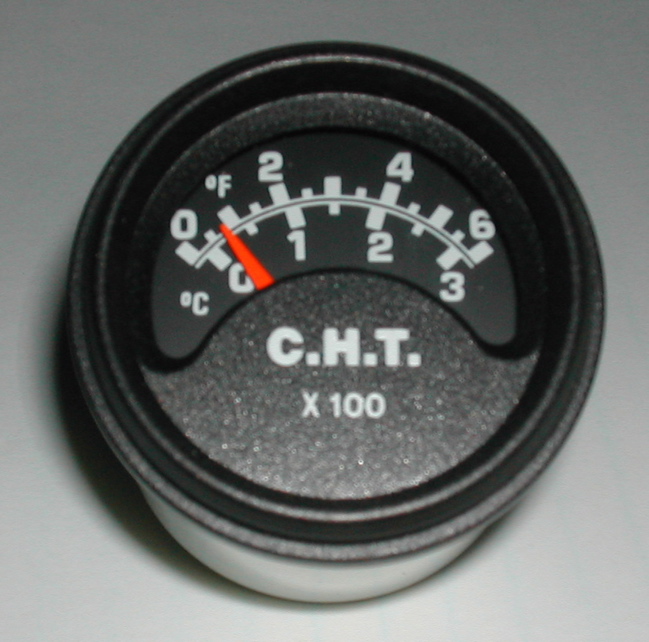

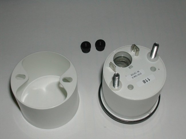

Just as I promised! (IMG:style_emoticons/default/biggrin.gif)
Here are the parts:
CHT Gauge
This is the Micro 1000 gauge as mentioned. It ranges from 0-600 degree F or 0-300 degrees C. The top row of numbers is F, the bottom row is C. It's got two thumbscrews on the back for the collar that will hold the gauge in the dash (or wherever). It comes with a bulb assembly included for night visibility (I forgot to take a picture of that). The back has a + and a - connection for the wire extension.
(IMG:http://www.914world.com/bbs2/uploads_offsite/www.paintandmetal.com-419-1271116925.1.jpg)
(IMG:http://www.914world.com/bbs2/uploads_offsite/www.paintandmetal.com-419-1271116926.2.jpg)
This is the link to buy the gauge.
