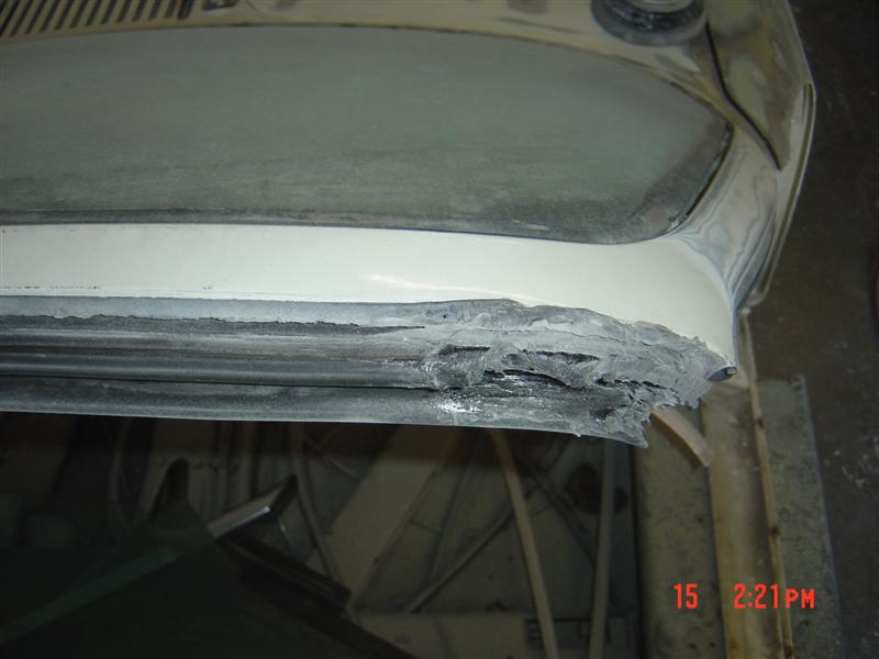

I pickep up Jim's car last weekend and got started on it today. Car will be pretty much stock. For right now I will be taking care of the metal work, after that is done I will either continue on with the body and paint, or Jim will take it back and do some of that himself. Any way, here we go (IMG:style_emoticons/default/smile.gif)

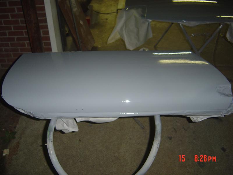

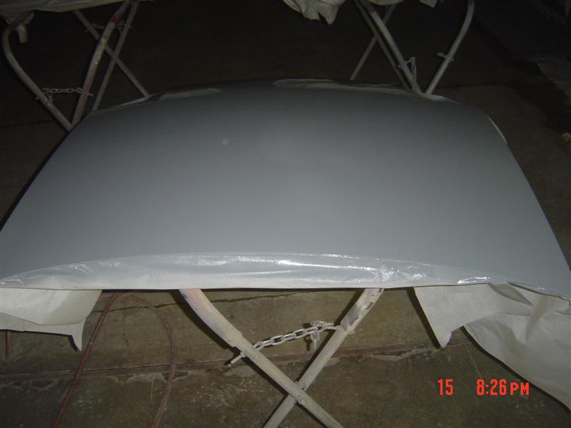

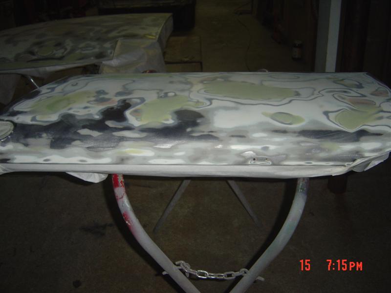

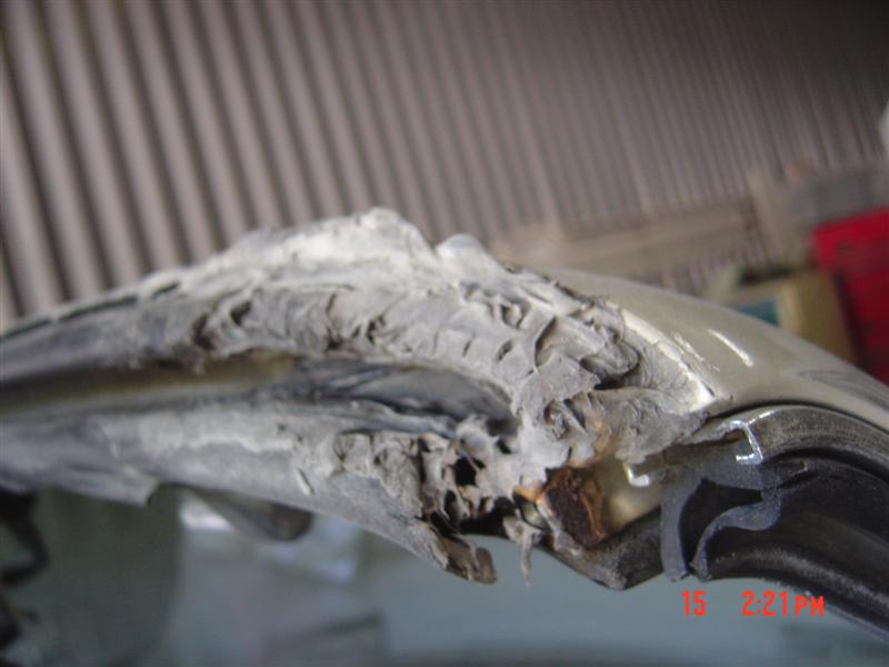

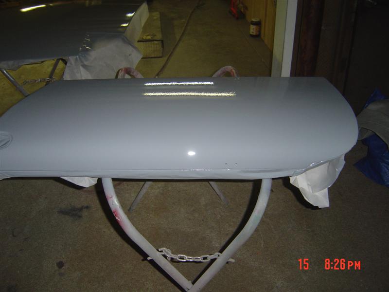

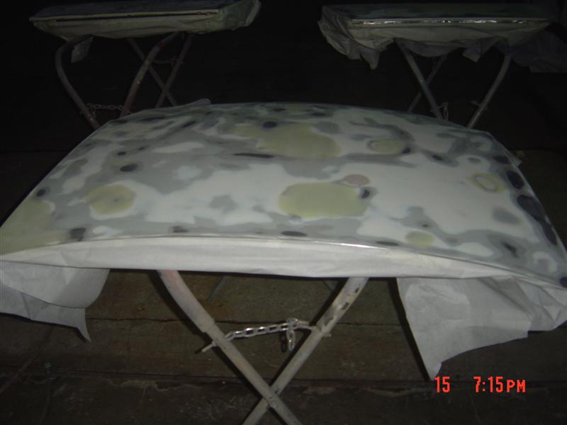

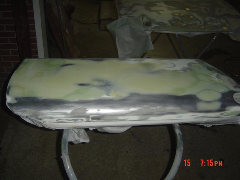

Epoxied, sanded and high build on the doors and rear trunk lid and epoxied the body and front trunk. Found some uglies when I wire burshed the front trunk channel that will need to be addressed (IMG:style_emoticons/default/sad.gif)

scotty b This is most of the bondo I removed from the trunk... Jan 18 2010, 06:53 PM

scotty b Had a fubard week and didn't get a whole lot o... Jan 23 2010, 07:46 PM
scotty b Note the layer of rust scale inbetween the 2 layer... Jan 23 2010, 07:48 PM
scotty b If anyone has a car they are cutting up I need the... Jan 23 2010, 07:50 PM
