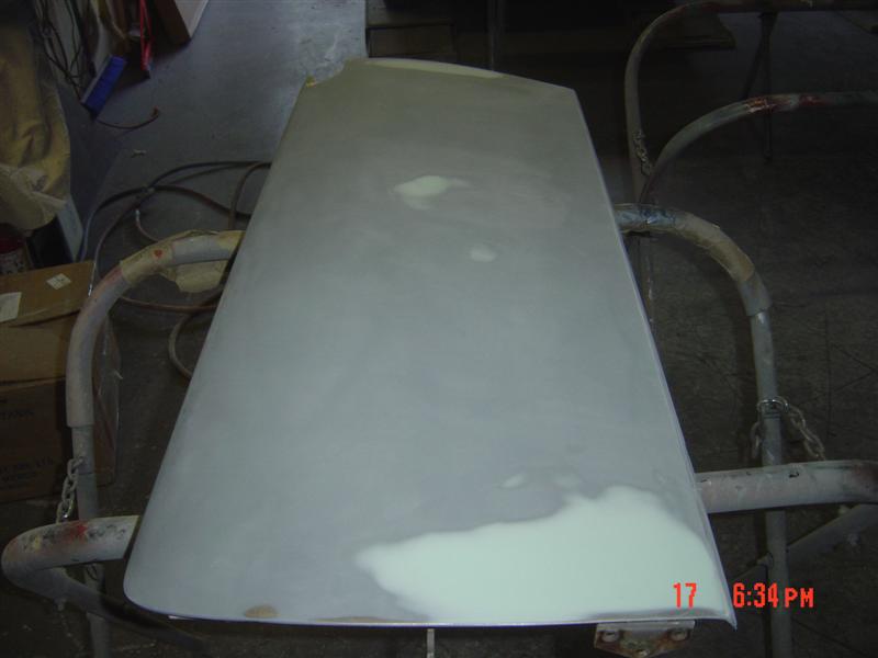

scotty b nothing spectacular to show. I pretty much finishe... Apr 14 2010, 07:39 PM
scotty b :welder: I plan to have the body work and rust rep... Apr 14 2010, 07:44 PM

watsonrx13 Scotty, after you have sanded the filler down, do ... Apr 15 2010, 12:29 PM
scotty b
Scotty, after you have sanded the filler down, do... Apr 18 2010, 07:03 PM
scotty b Epoxied, sanded and high build on the doors and re... Apr 18 2010, 07:11 PM
