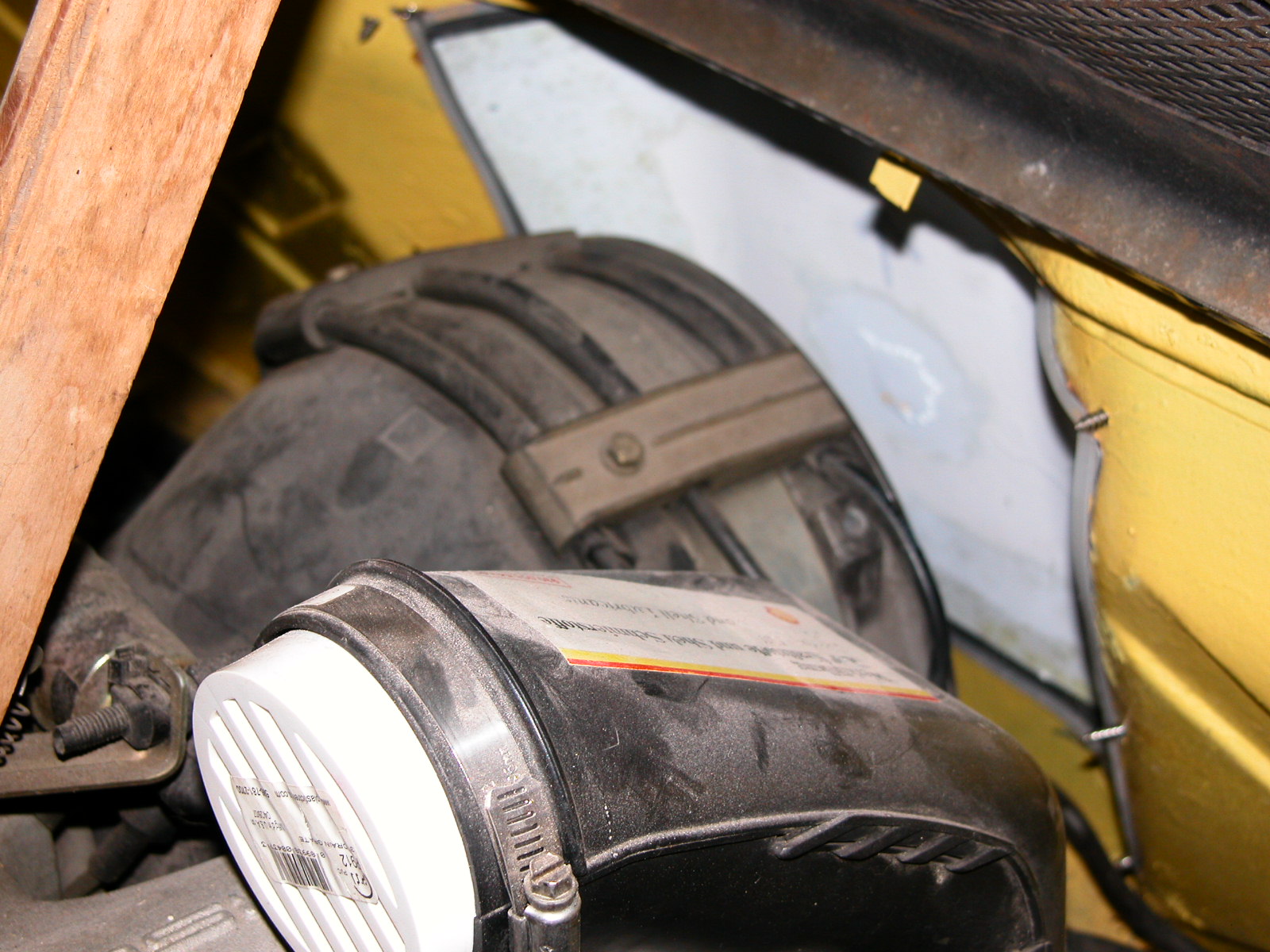

Here's another view, this view is obviously from the engine compartment.Attached Image
That white thingy is a PVC grate, that plugs up the heater fan system but still allows some airflow. I am using headers, not heat exchangers, so the heat system in my conversion is all electric. 12v RV hair dryers provide defrost, an aircraft heater provides footwell warmth, and heated seats warm the keister. So when I burn up my alternator, it'll be a good thing I have this access panel.
Yep that's a piece of wood holding up my GT engine cover.
